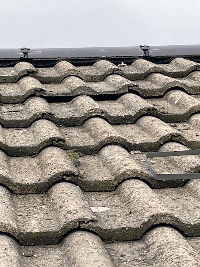

I had to have the battens replaced on one side of my roof.
The existing tiles were put back.
But one looks like it is on the wrong way around. Pic attached.
The contractor says this is for ventilation of the roof and is an eve tile.
Is this correct?
Thanks.
Looks like It's a damaged tile . Better he put it on the bottom course if there are no spares.
Tile next to it isn't sitting right either.
Probably a tile chip stuck under it .
Looks like someone didnt push the adhesive strip down under the ridge tiles properly either.
The black strip under the ridge tile which has the corrugations on the edge I'm sure has an adhesive strip down both side to stick to the tiles.
