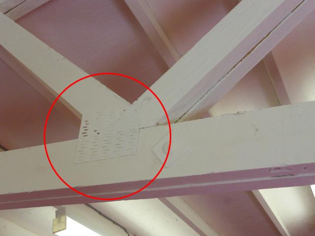

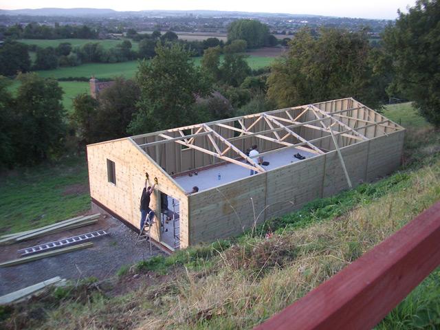

I'm building a large four port garage in timber, essentially copying the pre-made one we bought from Chart Stables at our old property.

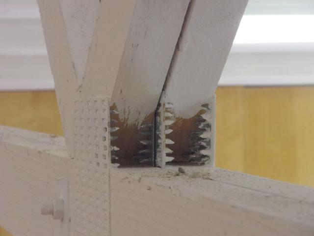

My question is about the roof trusses. The previous ones had metal plates that look kind of like nail plates, but they are pressed out so that the 'nails' are all part of the plate. They were fitted on to the sides of the truss where the wooden sections meet.
See images:
Looking at images of trusses it seems that these plates are quite common in truss construction.
I had a look at my local building suppliers and they do lots of roofing stuff, and nail plates, but none of these types of truss plates.
I've Googled and found these:
http://www.raygrahams.com/products/...g-plate.aspx?gclid=CP355_SYlcACFfOhtAodYioAzA
http://www.wickes.co.uk/Wickes-Mend...43364522812|&gclid=CODpqfKYlcACFcsJwwodIzQAbA
But it specifically says in the images NOT FOR TRUSSES!!!
Need some help here guys. Why are these not suitable (too soft a steel??) and where can I find some suitable ones online? It seems these are used on most trusses, so can't believe they're so hard to find!!
Many thanks!

Yes, the name mending plate did confuse me. But they seem to be used on most wooded trusses as standard?? Or at least something that looks a lot like them.
Why is it such a mission to build your own trusses? I have the design and measurements already so an unsure why it's such a big thing??

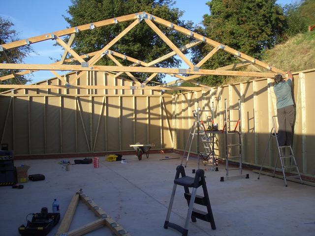

Images of what we'll be recreating from our last (Chart Stables) garage:
The metal plates on trusses are pressed in by machine under factory conditions; they are not intended for knocking in with a hammer.

Firstly, it is not impossible to make a truss. It is just not very easy to make a truss like they do when they make factory manufactured trusses. These are made with minimal timber and gain a lot of their strength from the design and the gang plate hydro-nails.
To do the same yourself would require heftier timber and a lot of joinery.

The main thing about these factory made trusses is the quality of the timber, that why there are so skinny as compared to 6" X 2" of home made roof structures. The main purpose of the metal which is circled in red is to keep every thing in the correct position until the roof is fully loaded when they could be removed as the weight will lock the struts as they are. But without them, craning the trusses or loading the roof asymetrically would cause the whole truss to fall apart.
