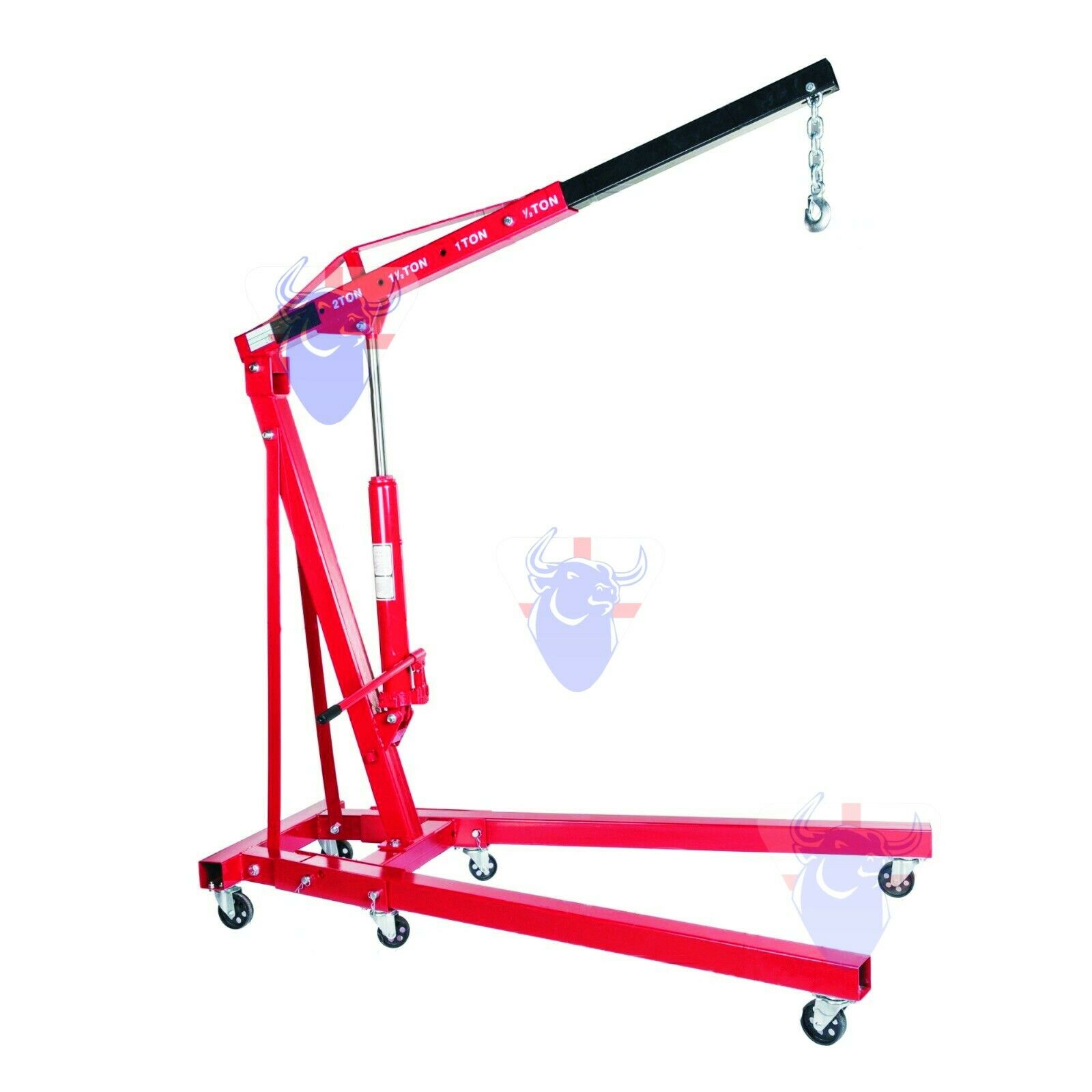

Very unwise. Make a tripod- 3 bits of scaff, 2 swivel clamps and steel wire rope to restrain the bottom of the legs.
tool hire shop
