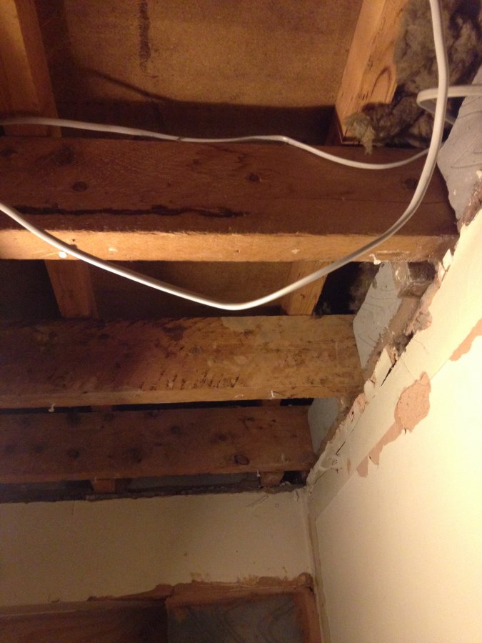

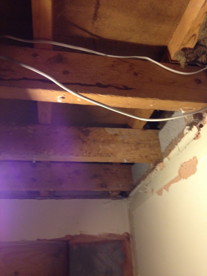

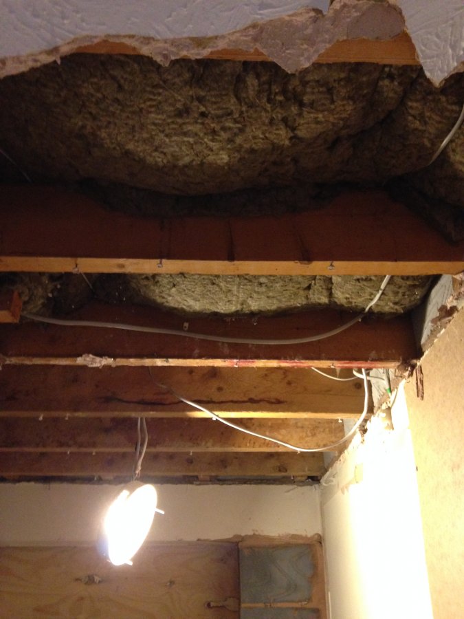

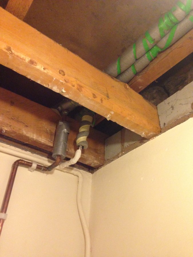

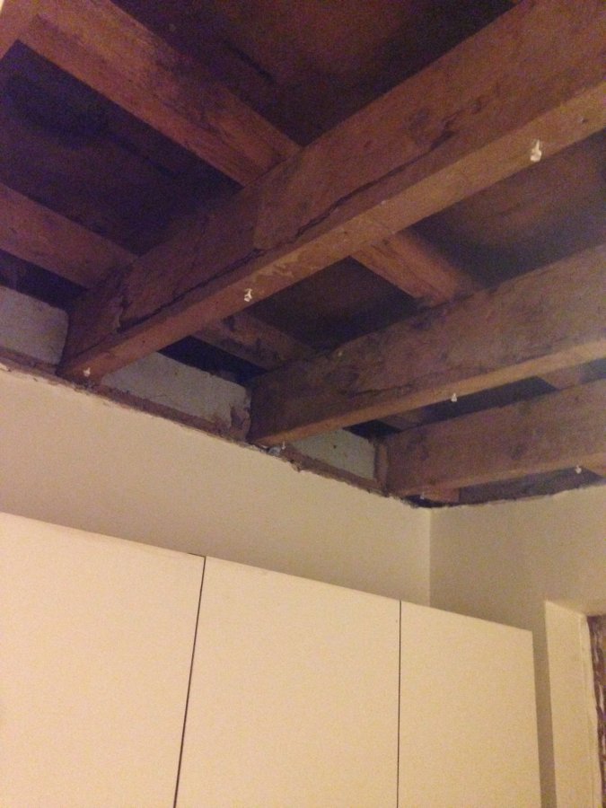

Hello,
I've moved into a house with an old flat roof extension which has a bathroom in it. I've stripped out most of the room and removed the plasterboard ceiling. It has exposed the underside of the roof which did not look well insulated. There were a few rolls of old fibreglass type quilt and I removed those too so I have a completely empty space. I am about get quotes for new plastering of the bathroom and thought I would get new insulation put up there before it. Could someone please advise me on what the best form of insulation is, how it should be installed, where ventilation space should be and anything else I could do to improve the existing roof. I can't afford to have the thing rebuilt, but need a new bathroom in it. The top joist beam is 3" deep and the larger cross joist is 6". The sides of the roof have wood panels covering them and air flows through the gaps around it. Here's some pics IMG_0706.JPG IMG_0708.JPG IMG_0711.JPG IMG_0713.JPG
What are these kinds of roof called: warm or cold decked? Are any extra precautions needed, as it is a bathroom that will be more humid.

I would leave the top timbers free of insulation, this will allow for ventilation. I would then insulate the remaining 6" depth fully with 150mm earth wool.
Then before boarding fit a vapour check barrier to the joists
or use foil back plasterboards.
I assume the electrical cable is lighting only, if not then they would be best left/clipped outside the insulated areas.
A warm roof is where the insulation is above the deck of the roof
A cold roof is where the insulation is below the deck of the roof.
Yours would be the cold version, if you intend to insulate the void of the deck.
