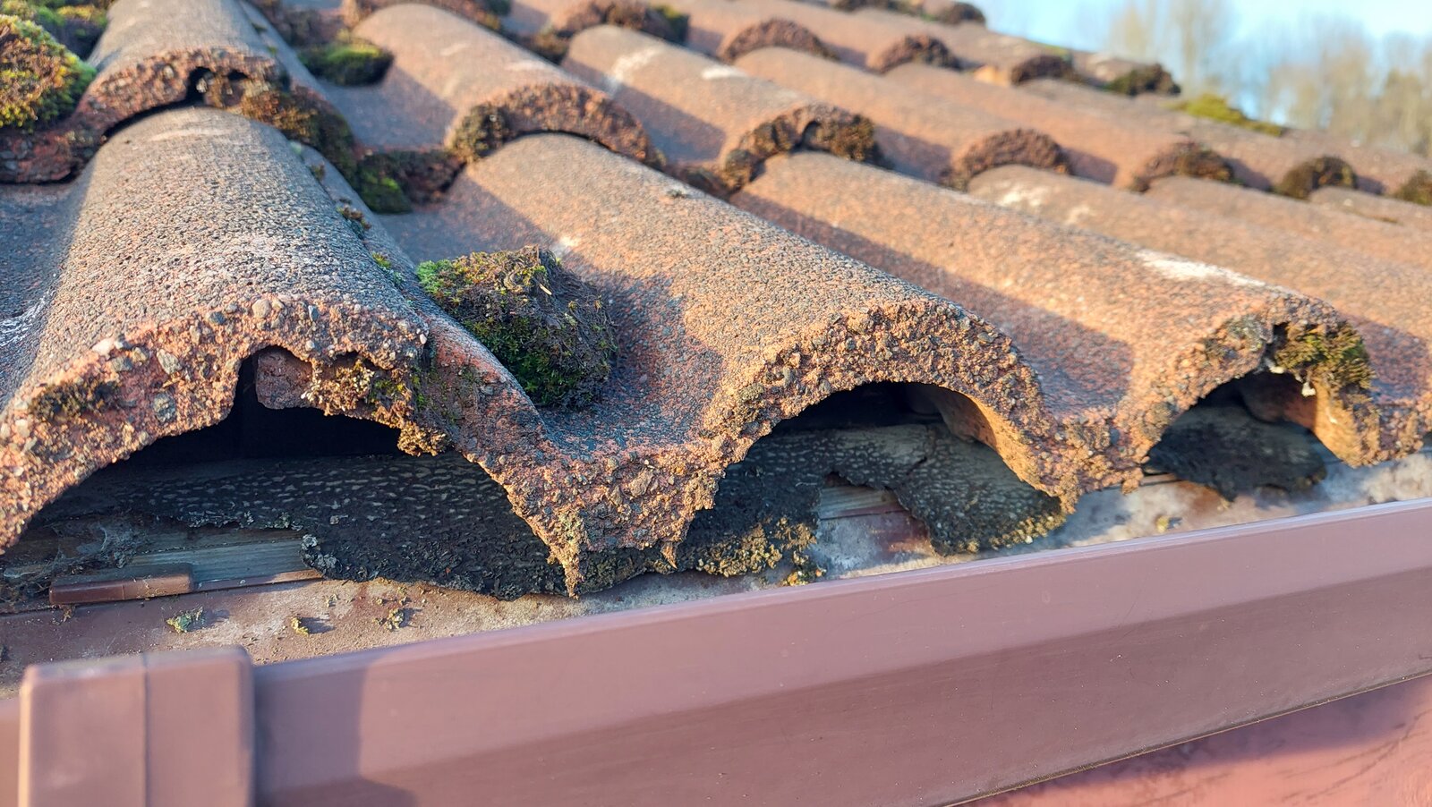

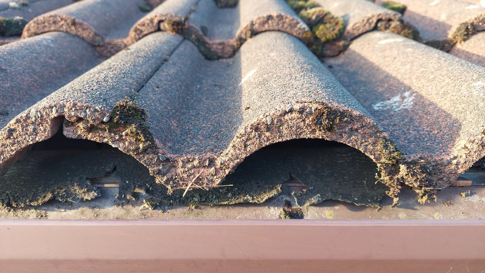

Hi, see pics, felt degrading. How straightforward is it for a roofer to patch/repair this? Bungalow so not working at increased height. Can a strip of felt be fed in under the degrading section or not as simple as that?

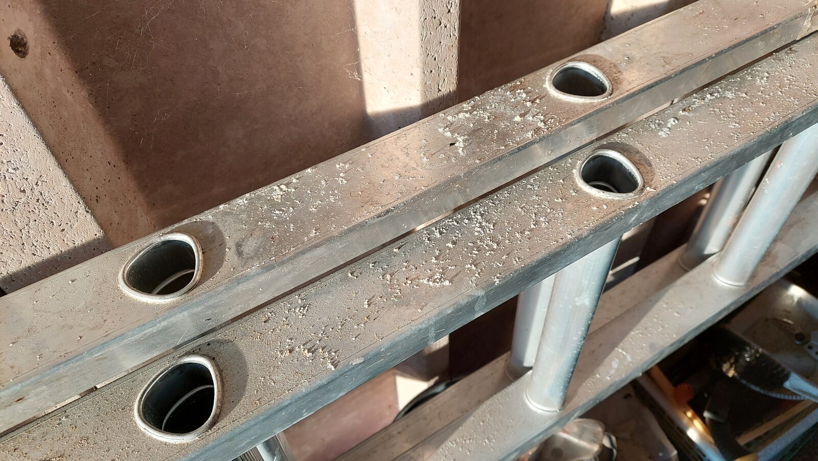

Also see pic of ladder stored in garage with roof that's covered with cement/asbestos sheeting. I often see this white stuff forming. Am I right in thinking it's of no concern i.e. salt crystals or something? In other words it's nowt to do with the asbestos fibres? Sheets seem pretty intact.

Get some eaves trays fitted at same time. Roofer will need to remove tiles and battens to replace the bottom layer of felt.
