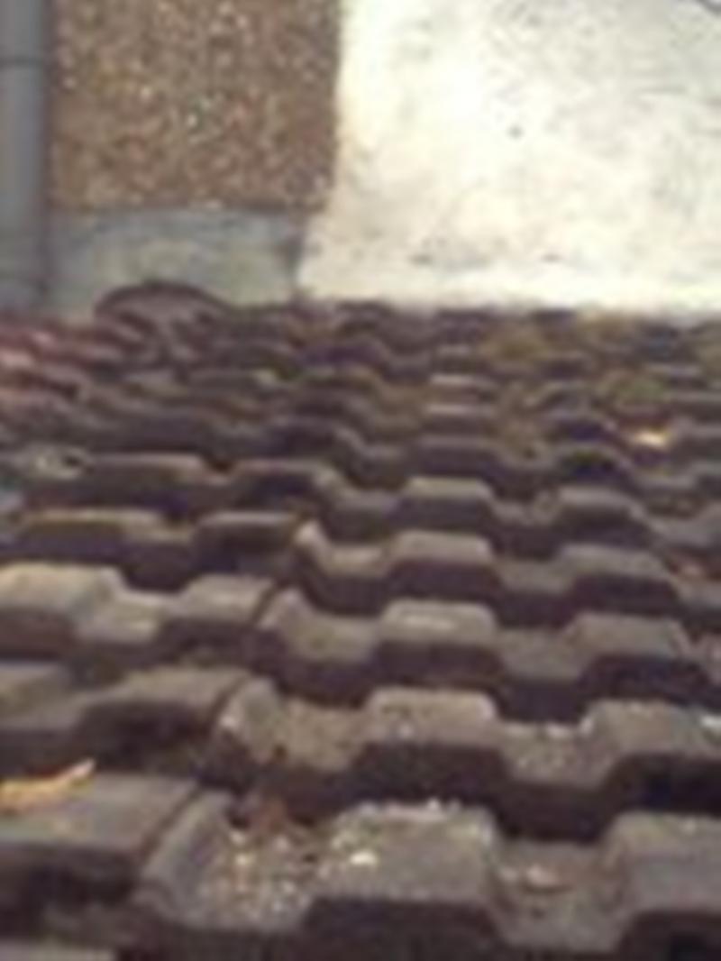

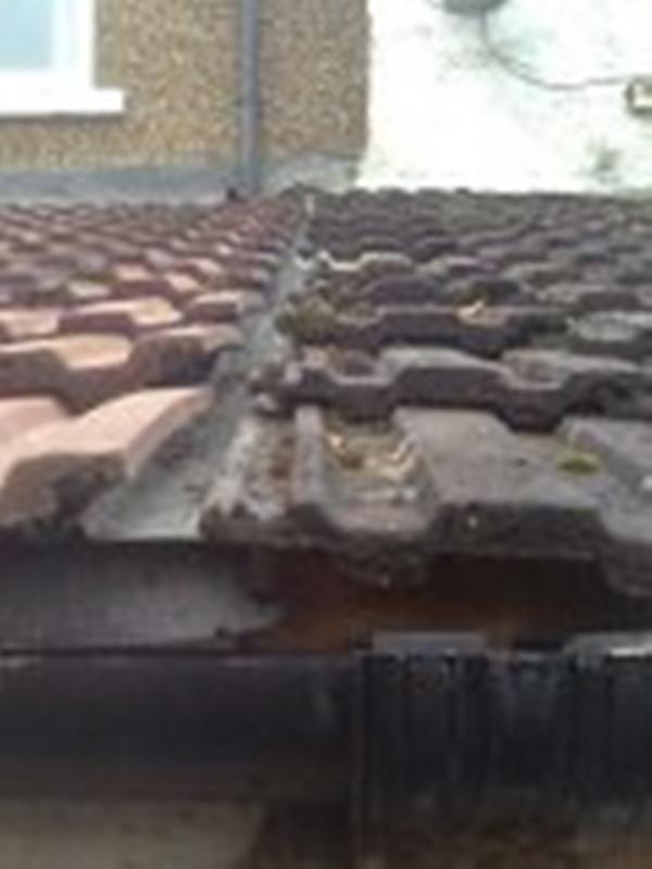

hi guys and girls,my neighbour had a leak in his kitchen,his builders where in today and reslated his side of the roof,before there was ridge tiles running down the middle seperating the two roofs,this is how they left it,there is a metal kind of drain in the middle now but my tiles dont connect up now and in sure when it rains again,its my kitchen that is going to be flooding.
what do u think of it,heres
some pics,sorry only had moblie phone,cheers
You photos are microscopic, but it looks like they have fitted a joining gutter, which is a common and acceptable method of joining two different tiled roofs.
If its been done properly, then it should be OK

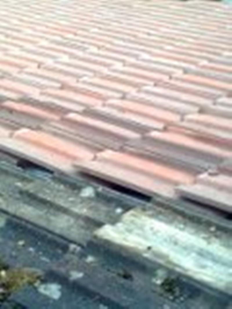

also in this pic,wats to stop the wind getting in below the tiles and the whole foof coming off,at least the middle ridge tiles held and joined the 2 foofs together,also from half way up to the top the tiles not bed together.
both sides now have nothing holding down the last row of tiles,only the one nail in the middle,f##king not happy about it at all,app the builders coming back around tonight,we will see what he says
latest,builder coming bact tomorrow to relay the ridge tiles back and rebed my tiles correctly,lets see,will update tomorrow night when i get back from work,lets hope there are no tornado warnings in london tonight
Not sure why they have done it that way as the tiles look the same profile.
