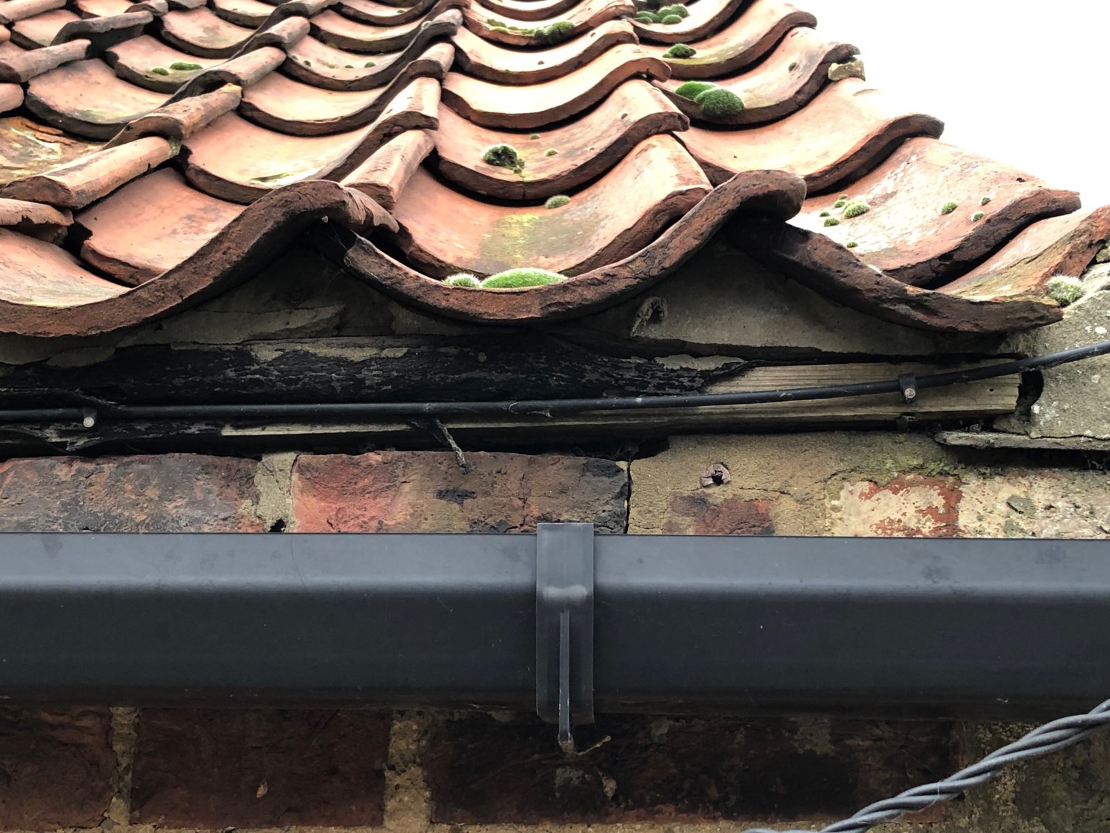

I have a barn conversion and the bottom row of roof tiles sits on a wooden beam where it joins the wall. Basically there is a timber that sits on top of the brick and the tiles overlap it at the bottom row. This timber is now rotten and needs to be replaced. Is it just a case of taking the last 2 rows out and replacing the timber, then cementing the arches under the tiles? I will be getting some quotes for this work. The building is solid brick walls and the tiles are getting old, so I also wonder if there is a better alternative to the terracotta arched roof tiles.

the rotten eaves timber needs a photo postin, it might be the wall plate your talkin about an thats not always a simple job to fix or replace
Hi. Sorry for the delay. I have pics now.
ok, when you put them back, it might be a good idea to tack some slate on the new timber then bed the tiles onto that rather than on the timber or in this case the felt..

Thanks for the advice. Would you consider this a big job? My roof is about 20m and I probably need both sides doing. Is it as simple as removing the tiles and replacing the wood?
not a big job, but as i said these come off easy, but harder to get to sit nicely when you put them back
