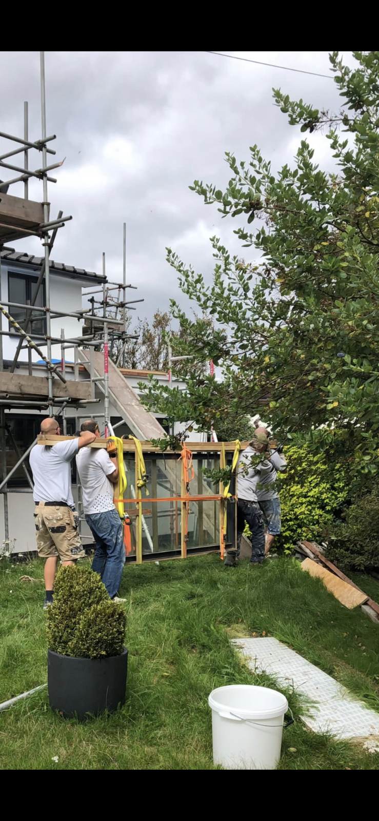

Took 4 of us to shift mine. Had 2 x lengths of 5 x 2 wood to shoulder it to carry round the house. Even with 4 strong blokes it was really heavy and was bending the wood.
It was then easier to pull/slide up the youngmans scaffold board…but if you don’t own one of them i would recommend a crane or a genie lift
