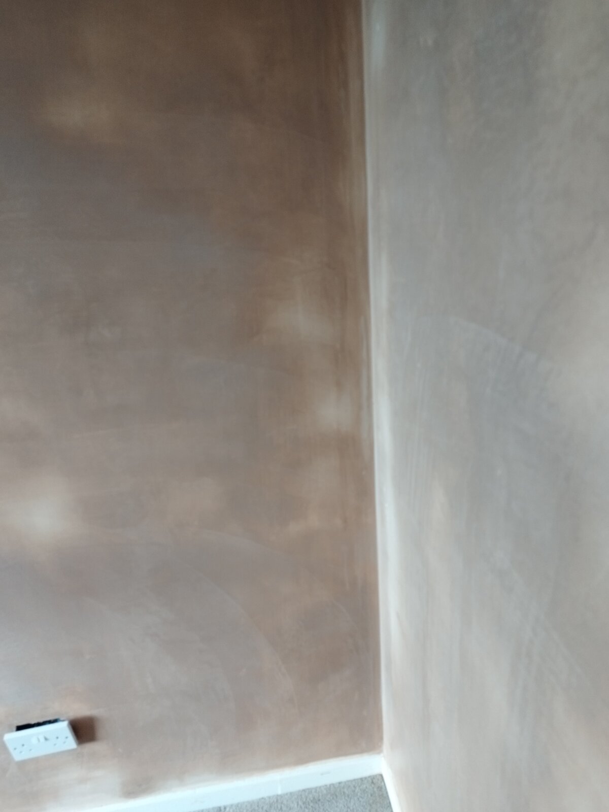

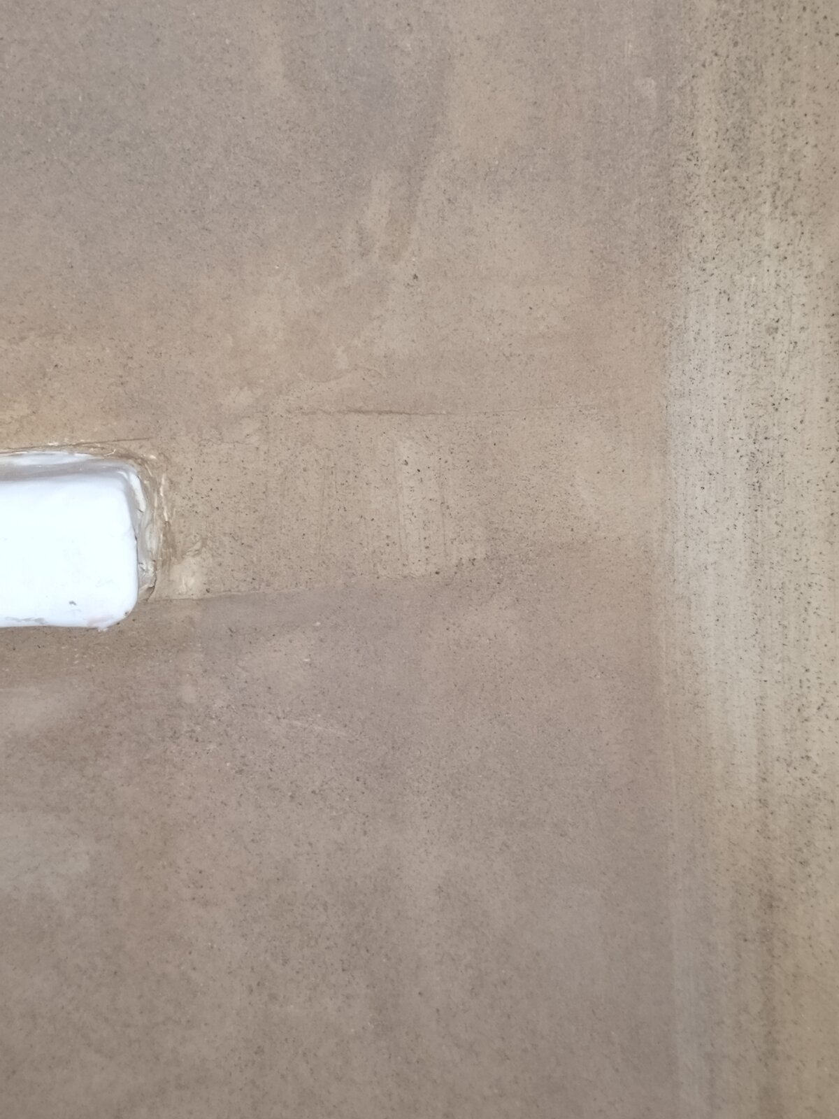

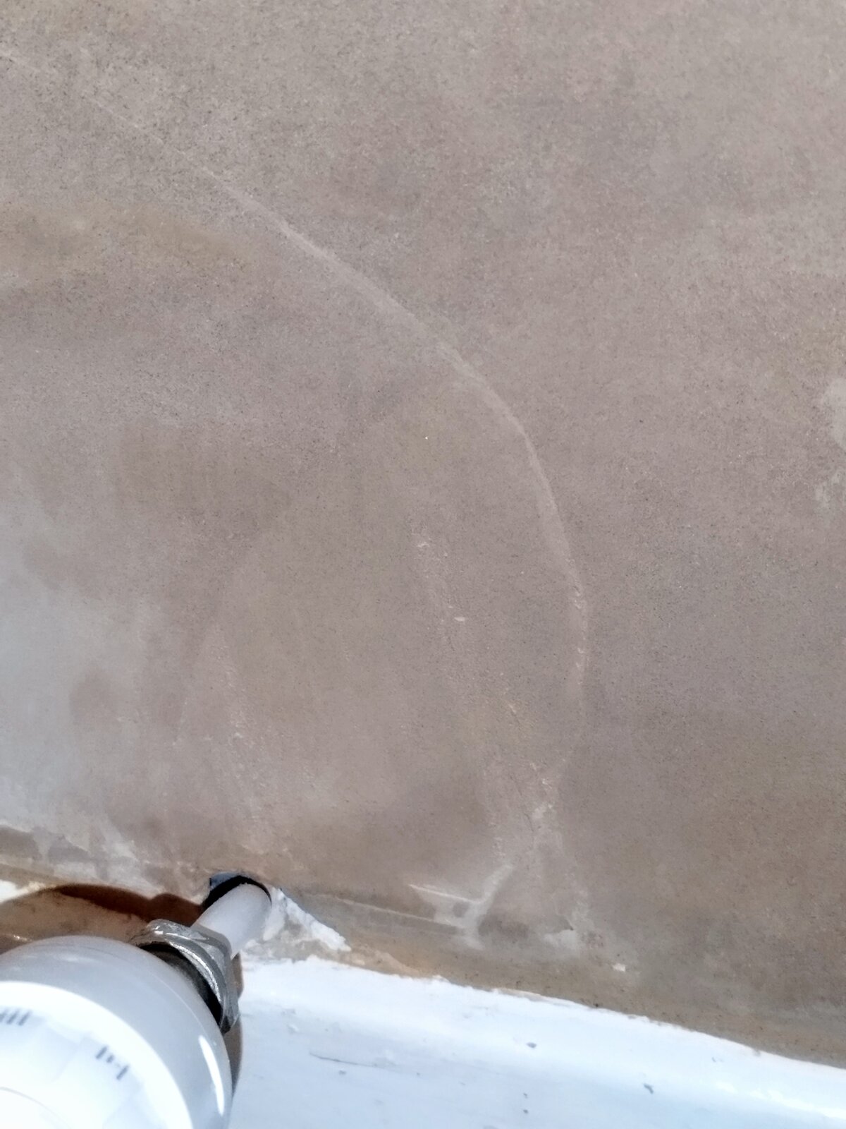

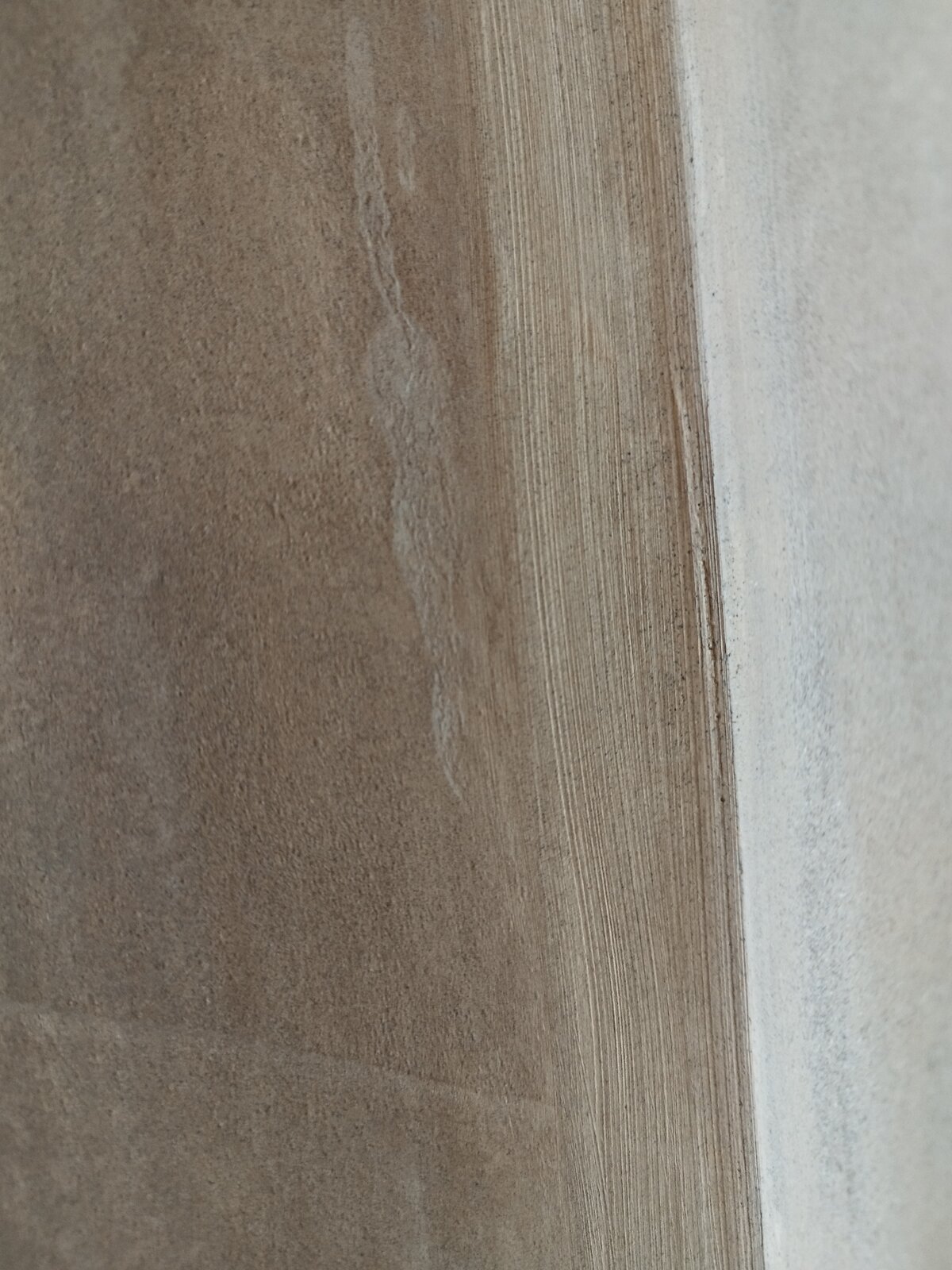

Had ceiling reboarded & skimmed+ all walls.
It's mostly the internal corners & a couple of other places I not entirely happy with.
Some of the internal corners, but not all feel rough to touch. Theres a couple of more bits too.
I think the finish should be better but wanted to run it past the forum before contacting them.
I would imagine the rough bits would have to be filled & sanded before painting otherwise these blemishes would show up easily.
I expected a few blemishes to sort out but am i being too picky. Some of the photos are not brilliant but hope you can see things okay. Cheers

Needs block sanding down edge when dry. Brush marks could of been eliminated better.
Can't really tell what wrong looking at photos.
If you call them back I'm sure they will sort easily.
I used to catch areas like that with my dustless sanding kit. Take minutes to sort
I thought the pics would be an issue
I'll give him a call tomorrow.cheers
