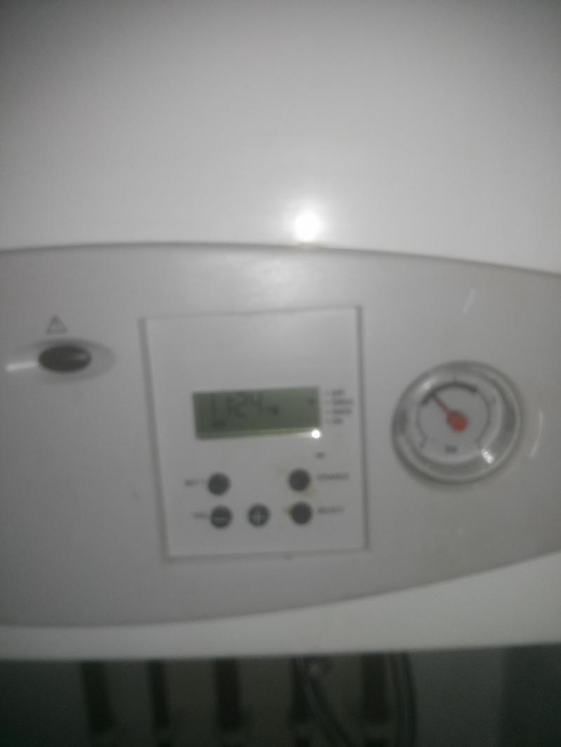

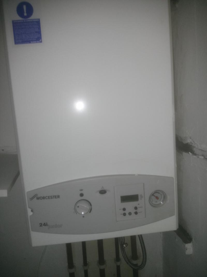

Hi,
I can check the documentation later on to see if that has an exact model number. In the meantime, here's are a couple of poor quality pictures, if that helps.
