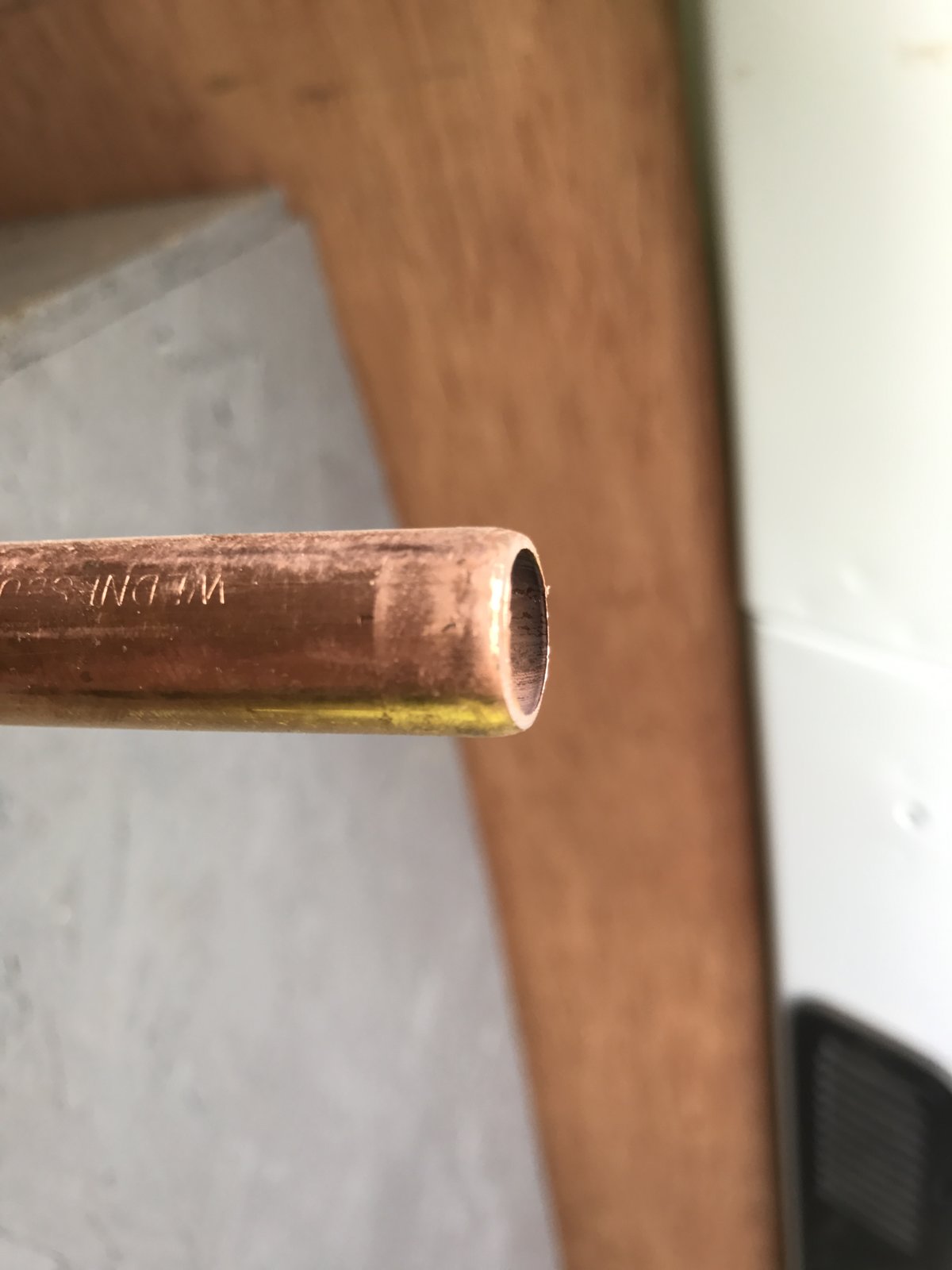

Hi I have used a monument mini cutter quite happily for many years but since I couldn't source a spare wheel locally I decided to purchase a Rothenberger automatic pipeslice from Screwfix here.
From experience using the adjustable mini slice it does leaves a burr but it is quite small and easily removed with a deburring tool, i.e., it leaves a very clean cut end. However I find that the Rothenberger pipeslice - very fast in comparison - does actually cut cleanly (hardly any burrs) BUT it does leave a considerably-sized internal edge all round internally. It literally forms the end so much so that you can see an obvious radius all around the outer circumference of the pipe - and subsequently a significant raised internal edge all around the inside.
I'm used to the old monument tool cutting very cleanly, leaving the end of the pipe 'even' all round, i.e., as good as new like that cut by the manufacturer, whereas the automatic one forms a folded end which I can't clear using my usual deburring tool (because its too substantial).
So is this normal to you experienced users? Is the turned end it creates intended by design (??), or might I have a duff one? I've been brought up not to create unnecessary reductions/restrictions in pipework wherever possible for good efficiency. Has the modern world relaxed its views on this?

I use a Monument Autocut which looks exactly the same as the one you linked.
It cuts like this:
The Burr created causes friction and turbulence. It should be reamed out. (Though in practice it seldom is ) !!
Thanks, yes it looks about the same sort of result Ian.
Terry any suggestion as to what example reamer will trim that much material away? I'd like to do it properly if I can, bearing in mind there is often not much access space for cleaning up existing pipework. Cheers
Most, if not all pipeslices will leave a turned over cut internally with the newer thinner walled copper. Get another Rothy product, I find this does the deburring job famously
