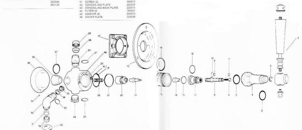

This is a thermostatic shower in a friends house. It is not mixing enough hot water into the output.
They have been taken over by Deva but they cannot give adequate instructions as to how to access the cartridge.
It seems rather more clever ( or seized ) how to get it open.
Does anyone actually know how to in relation to this particular unit?

sounds like the R995.
That looks like the unit!
That will be very helpful to me.
But have you ever opened one?
It seems that immediately on the right there is a ceramic insert which covers the screw which might be item no. 3
Any suggestions on removing that insert which does not seem to be shown in that drawing?

But this cap is domed ceramic and inset inside a tube in effect.
There is nothing to pull on, it does not turn and in an case how can you grip a hard ceramic dome to turn it anyway.
As it fits snugly into this tube there is no way to get anything past it to pull it forward!
Had I been able to get that out then I would have been able to take it apart.
Stumped right at the start!
If only I could open it then possibly all it might need is the temperature adjustment turning up.

The drawing mentions two filters, number 44 I think.
Unfortunately the drawing is not very clear.
Can you improve it or explain in words which are the filters?
Is there much of a chance the hot filter is well blocked?

Agile better view of the mixer.
your ceramic dome is it not like this one where you can grip the edge ?
once you can unscrew this then you can access the screw and remove handle to gain acces to the temp screw.

The dome in the small picture was not as thick and no flat surface protruded to grip. It was GLUED in place but the glue had failed and I was able to rotate it and then prise it out.
NOT a very sensible way to assemble anything!
I am still waiting to find a long enough and thin enough screwdriver to access the temp screw.
However, today I did what I was proposing and turned off water, removed outlet connection and front screw and sucked all water out. I then poured in 32% HCl and there was just a very little bubbling, nothing like as much as I had expected.
I left the acid in there and rotated the control a few times but nothing much was happening. I then warmed it up with a kettlefull of hot water and there was a little more bubbling.
Afterwards it was drained and reinstated and I quickly tested it with my hand and it did seem a lot better.
I also tried to undo the big nut "4" but that seems very solid and I dont want to break it.
