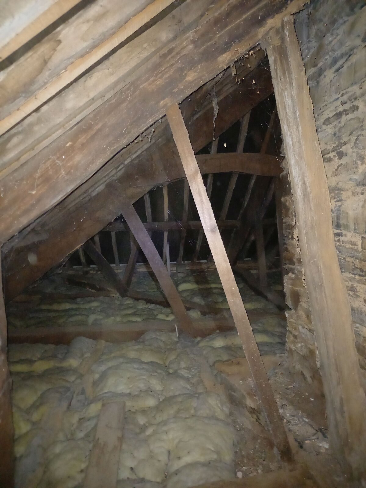

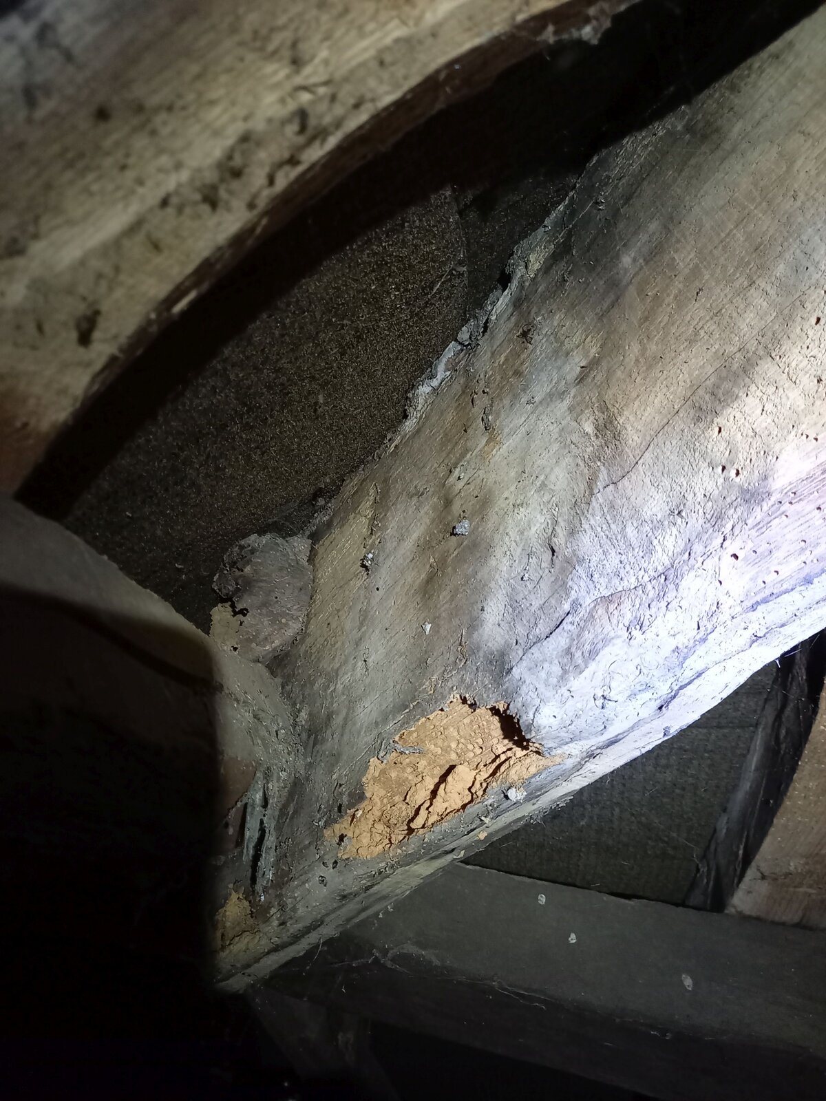

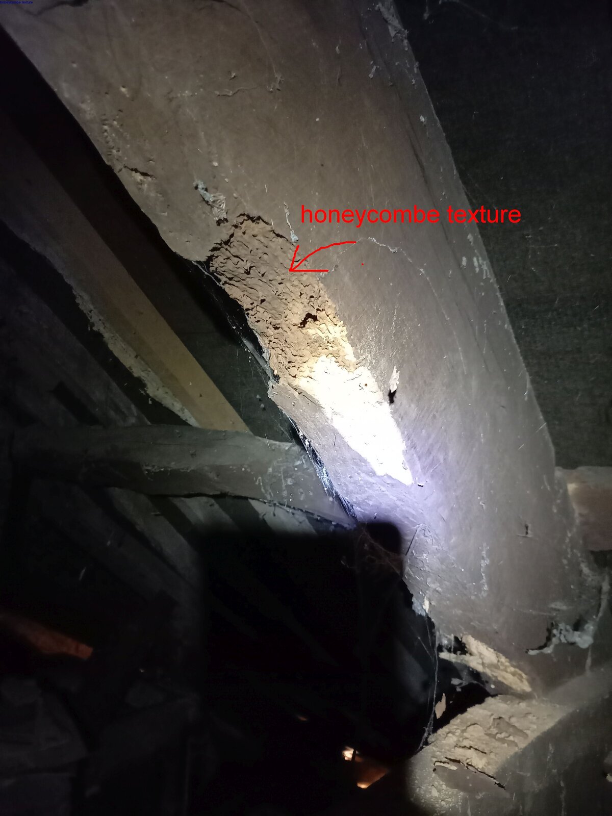

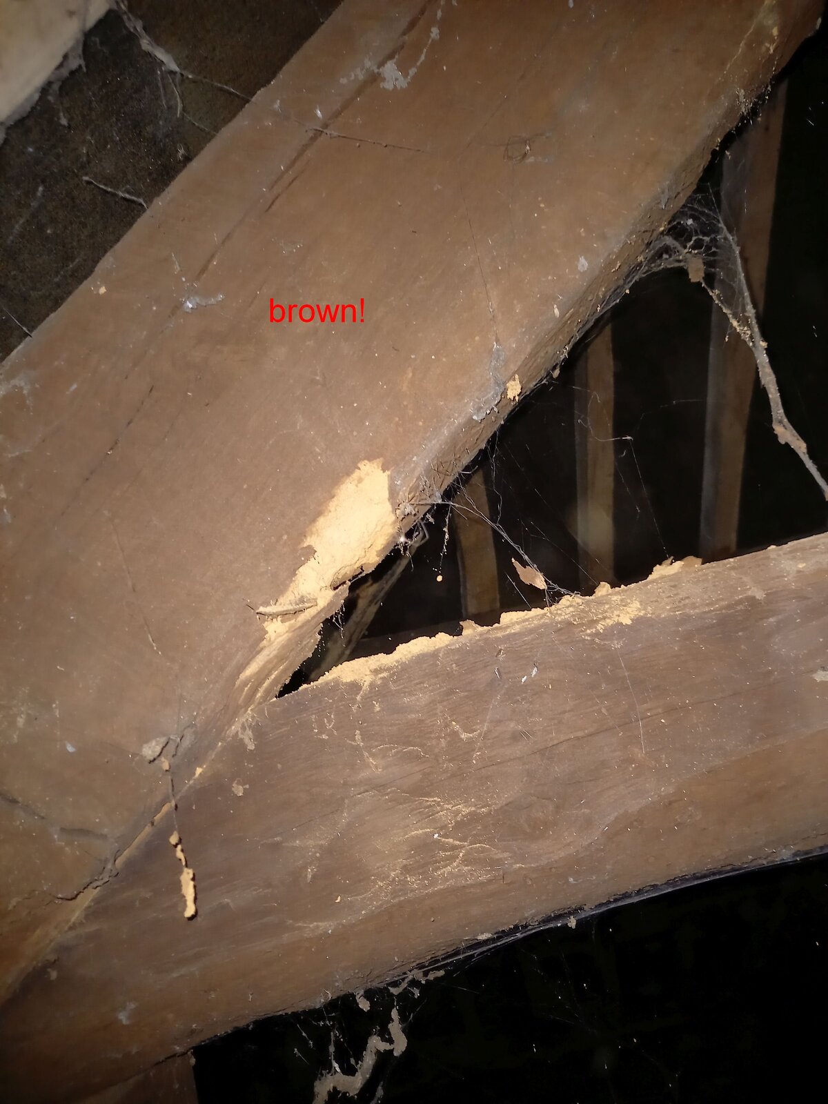

Hi All,
I went to see a property the other day which we're considering buying at auction. It's a couple of hundred years old & grade 2* listed. My main concern is the roof. There seems to be a mix of very old & newer timber. Lots of the rafters have the same problem: the lower third of the rafter is totally decayed & comes away easily into powder. The exterior of the decayed portion has a honeycombe texture & the whole rafter is a slightly odd dark brown colour.
My general understanding is that any decay needs moisture, but the strange thing is I can't see any indication of any moisture in the roof space and it looks sound from the outside - no missing slates or sagging areas. So what would have caused the lower portion of the joists to decay? And can I assume that because everything's dry now it'll be fine for the foreseeable future?
Thanks,
Adam

Any thoughts? I guess one potential source of moisture would be condensation resulting from the heavy sarking restricting ventilation & blanket insulation on the floor making the void cold - but wouldn't the decay work down from where the timbers touch the sarking in that case?
That's not rot it's wood worm/Beatle you can tell by the dryness and bore holes and powder left behind
Looks like it may be woodworm. The second picture, top left if you blow it up you can see what appears to be exit holes.
