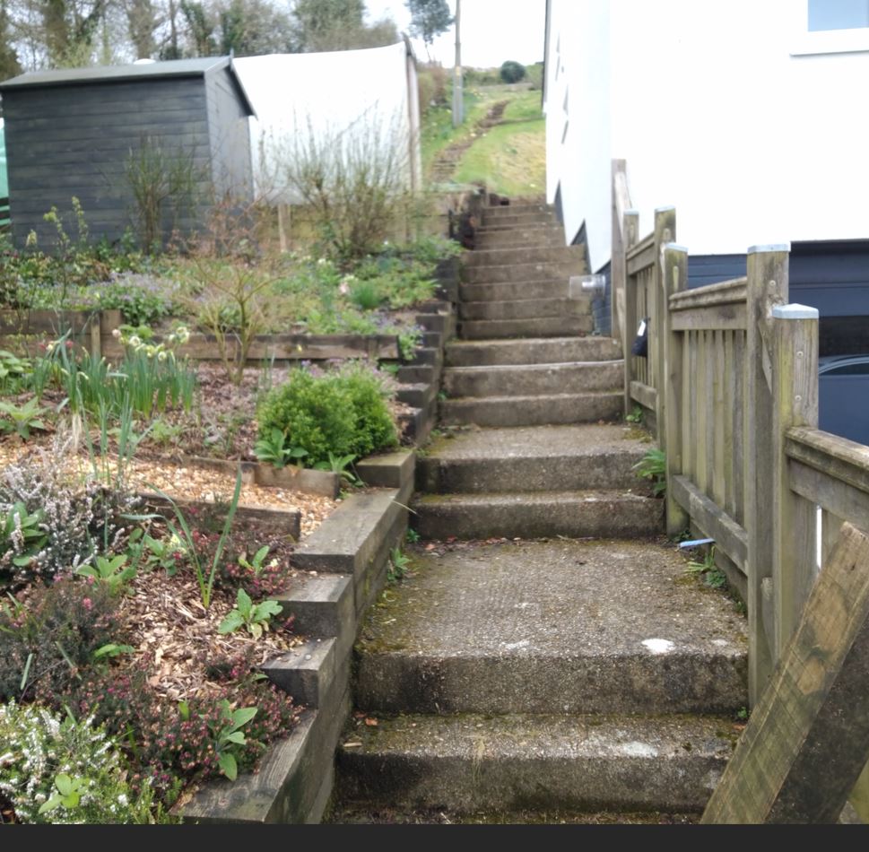

We had a bloke come and replace our knackered brick garden walls with some 'treated' sleepers some years back which looked lovely. Needless to say they all rotted out within a few years and I want to do something myself or get a chap in. We get quite a bit of moisture from the slope/field above seeping down and through the greensand so I need something more resilient.

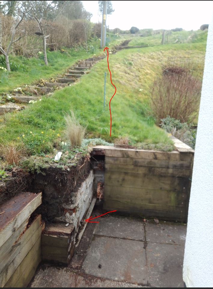

The existing blocks you can see have movement when I boot them so they need to come out to. I also want to make the 90 degree turn a bit wider in case I ever want to get a digger to the rear of the house or get a wheelchair round there. This photo is from the level rear of the house - which is up a double flight of concrete steps anyway - we are built into a hillside (this will be post #3)

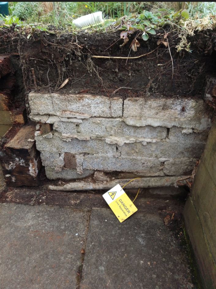

The red arrow marks an 11kV power cable (which was sitting just behind the sleepers). It then wiggles underground up to the nice pole in our garden. Ignore this for now as I'm sure I can just brick it over. There are concrete footings already in place. Not sure of dimensions yet.
As the wall is less than 1m high at its tallest bit - as shown. I think a double thickness of brick or laid-flat block is going to be OK? Given the amount of moisture seeping through I assume engineering brick or F2/S2 brick is going to be preferable to concrete block as less permeable? Is that right? I also assume I should put some gravel etc behind the bricks/blocks to reduce hydrostatic pressure?

I would ask them what THEY are going to do about it as it’s too near the surface and keep quiet until they decide
There’s a huge amount of supplies like this around and the suppliers might just improve it at little or no cost to you
Please let us know what they say
Thanks Murdochcat. That's the angle I'm going for. Not our fault the electricity folks did this back in mid 60s before the houses were built- but now its exposed by natural causes they need to do something. For now they've put a 'live' tag on it...so that's Ok then!

The only thing I would say is that instead of worrying about the porosity of any materials you will use ,and what I think should have been put behind the sleepers, is use a good damp proof membrane between the banking and wall. Also a big soak away would help if you can get a mini digger in. You could even build that cable into a cavity wall but not sure they would be too happy about that

In which case it creates a serious hazard. It is bad enough to have an 11kV cable exposed and accessible. How much information did SSE provide about the service ?
