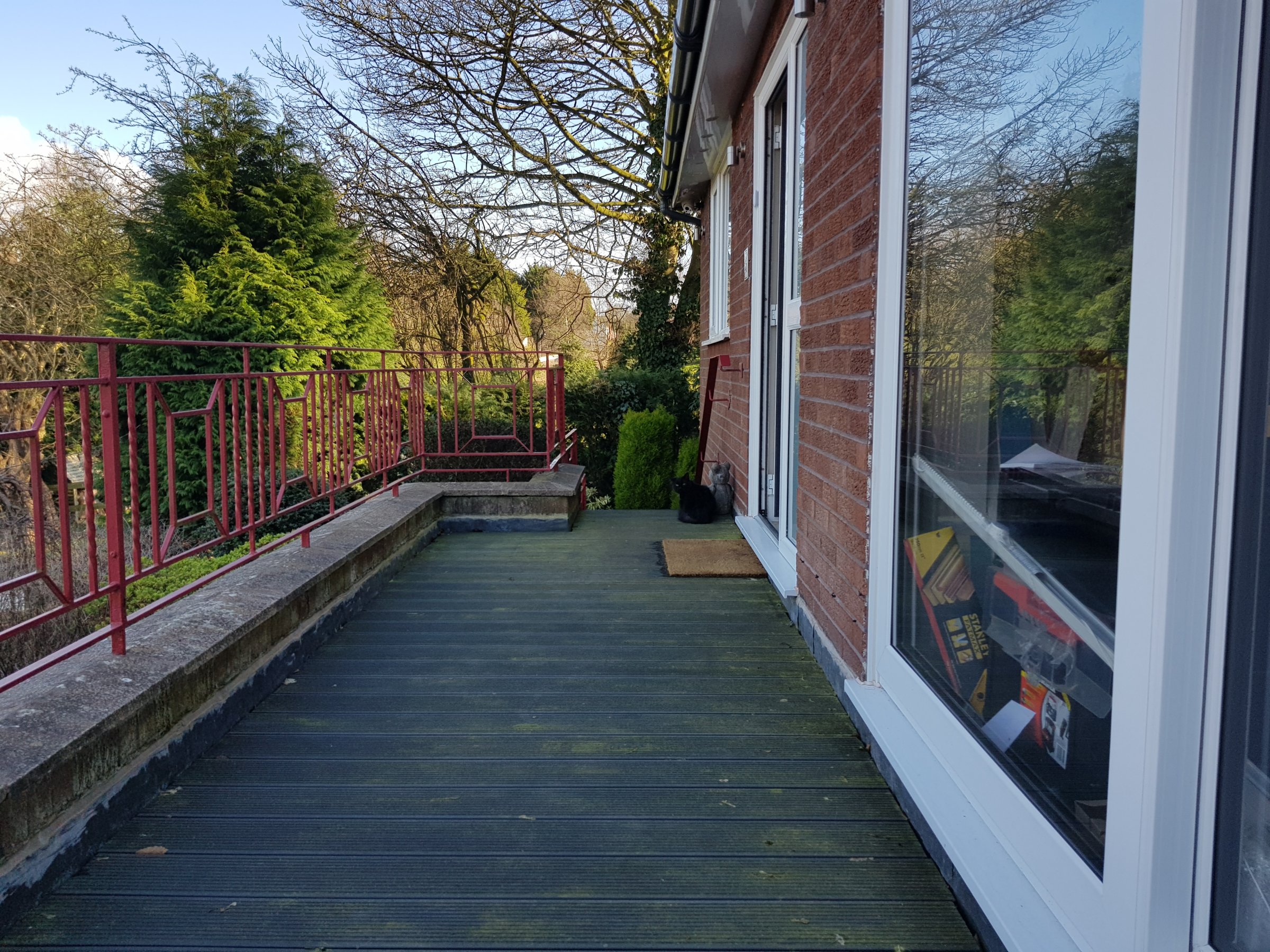

The house is built on a slope and the front door is on the 1st floor, accessed from a deck that juts out from the front of the house. The deck is suspended on joists. 1 third is over the lower hallway (which is where the problems lie) the remaining 2 thirds are the garage.
(the scaffold us not up anymore it's an old pic to show the house construction)
When we purchased the house the previous deck, made up of some kind of mortar and tile construction was letting in water in numerous places. We had the deck replaced with an epdm flat roof with composite decking on a floating timber frame on top.
So the construction now is composite decking, epdm covering, 18mm osb, 25mm floorboards then the joists.

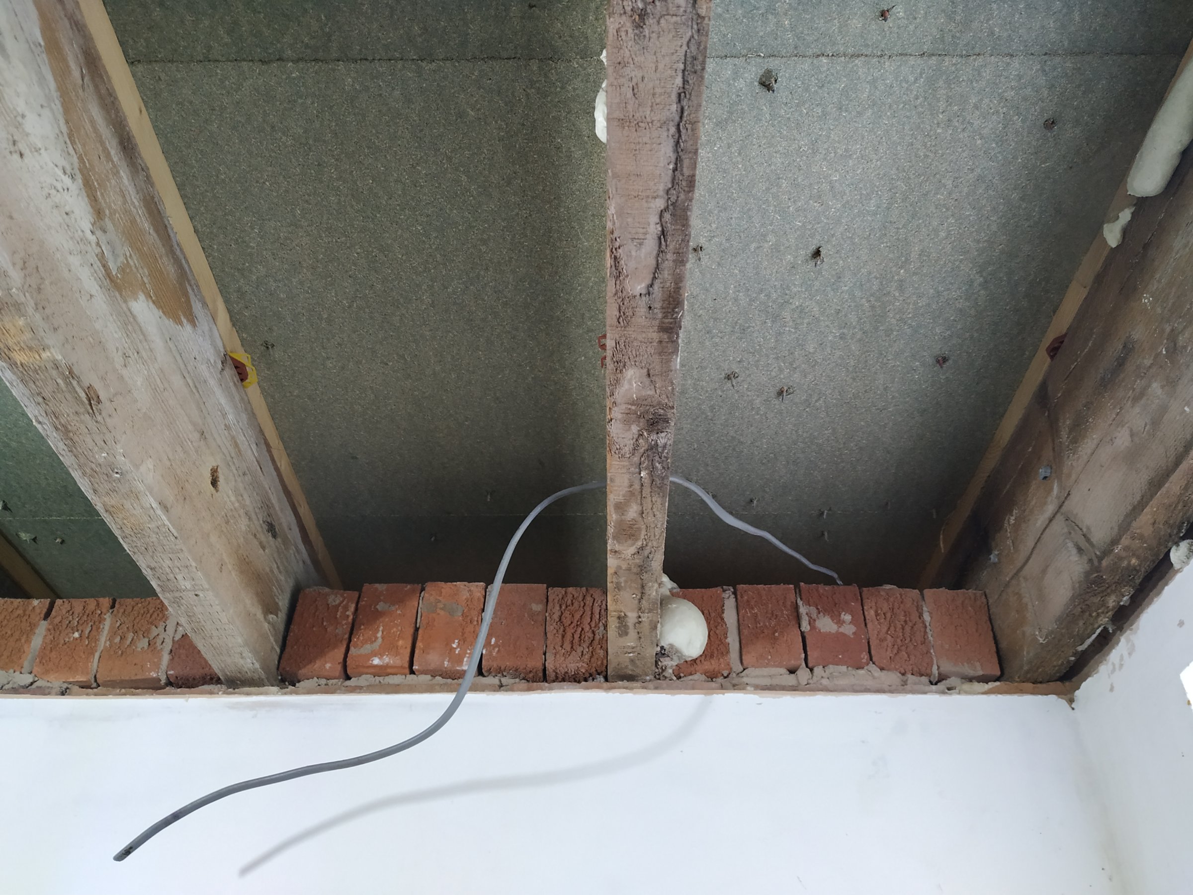

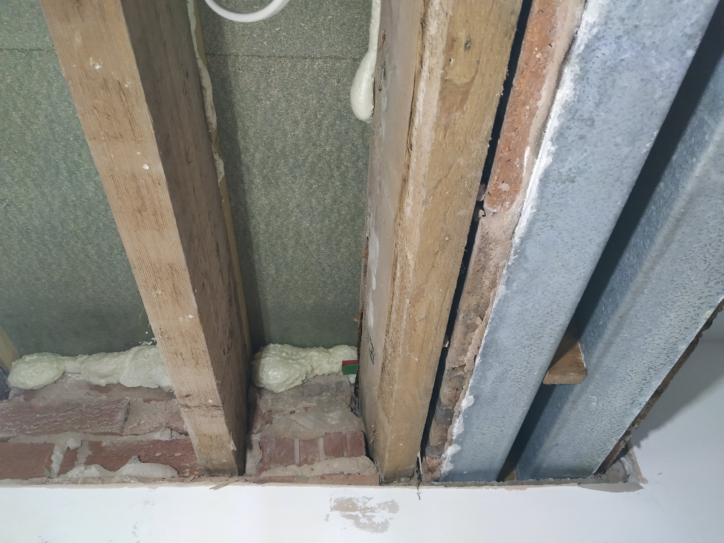

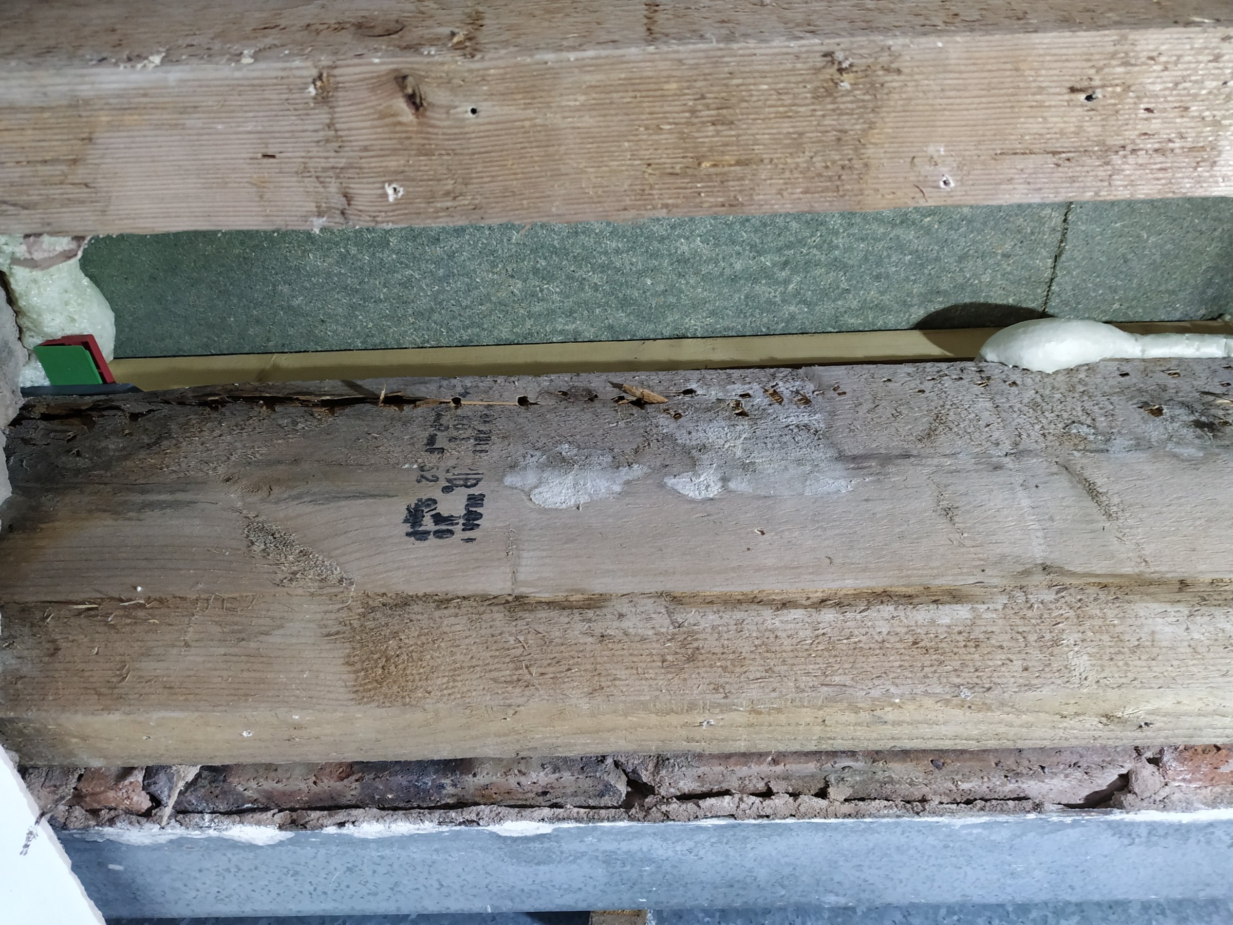

This is the worst one, I can push a screwdriver through the top along the top approx 500mm

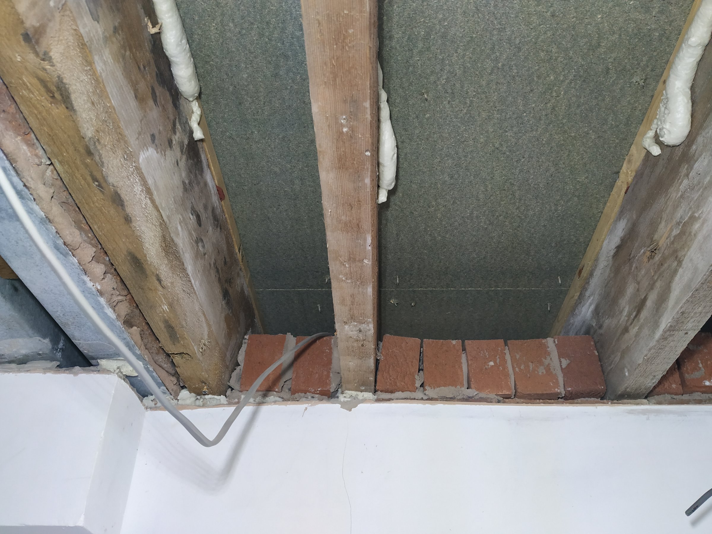

These joists look terrible but are not soft,

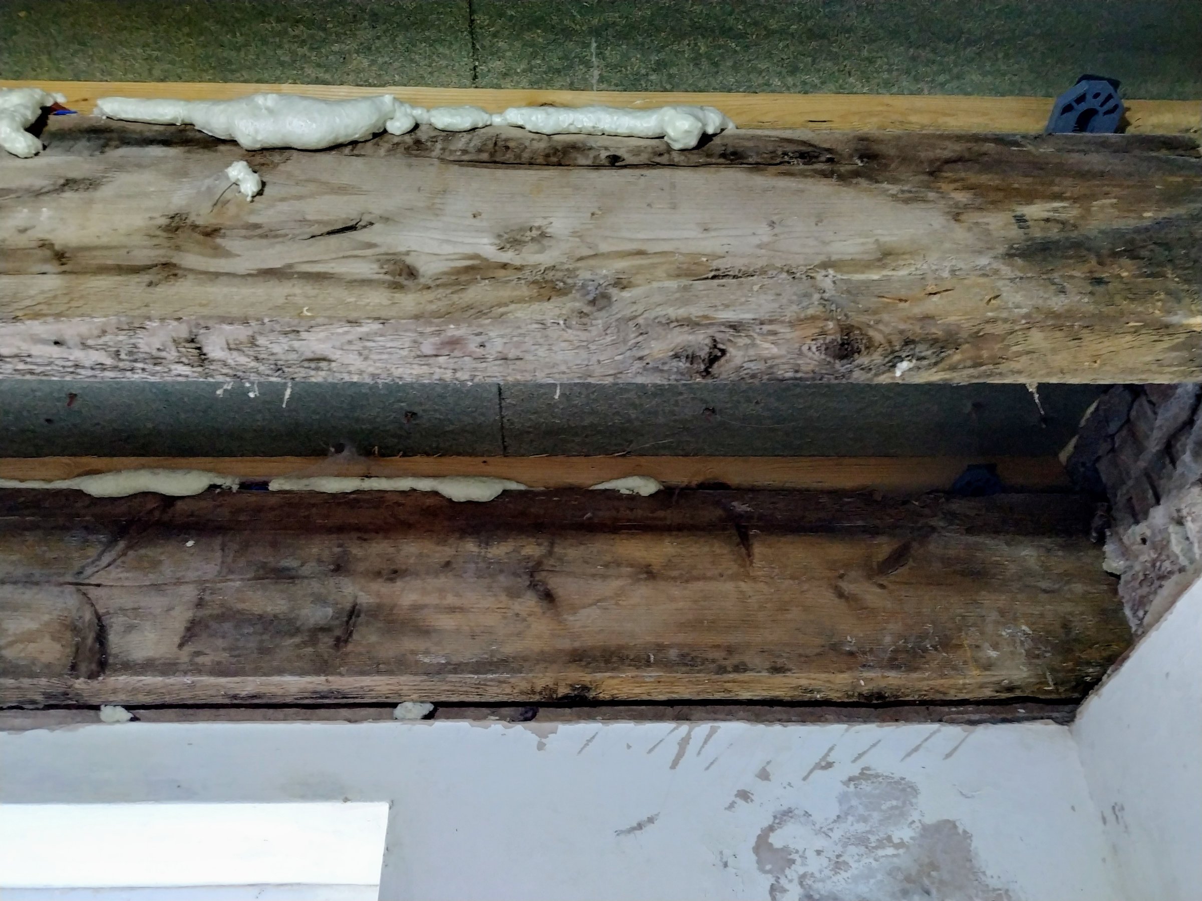

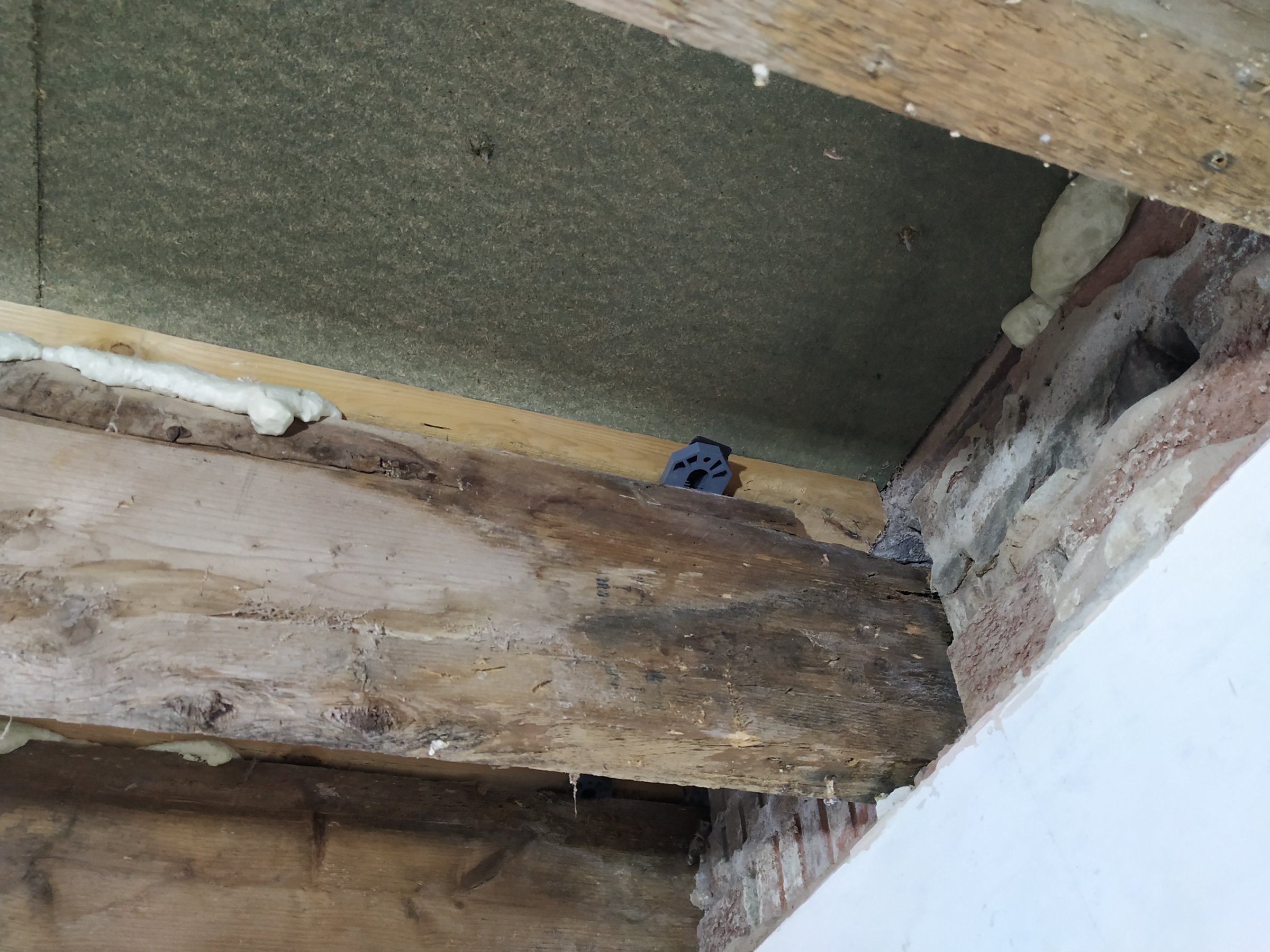

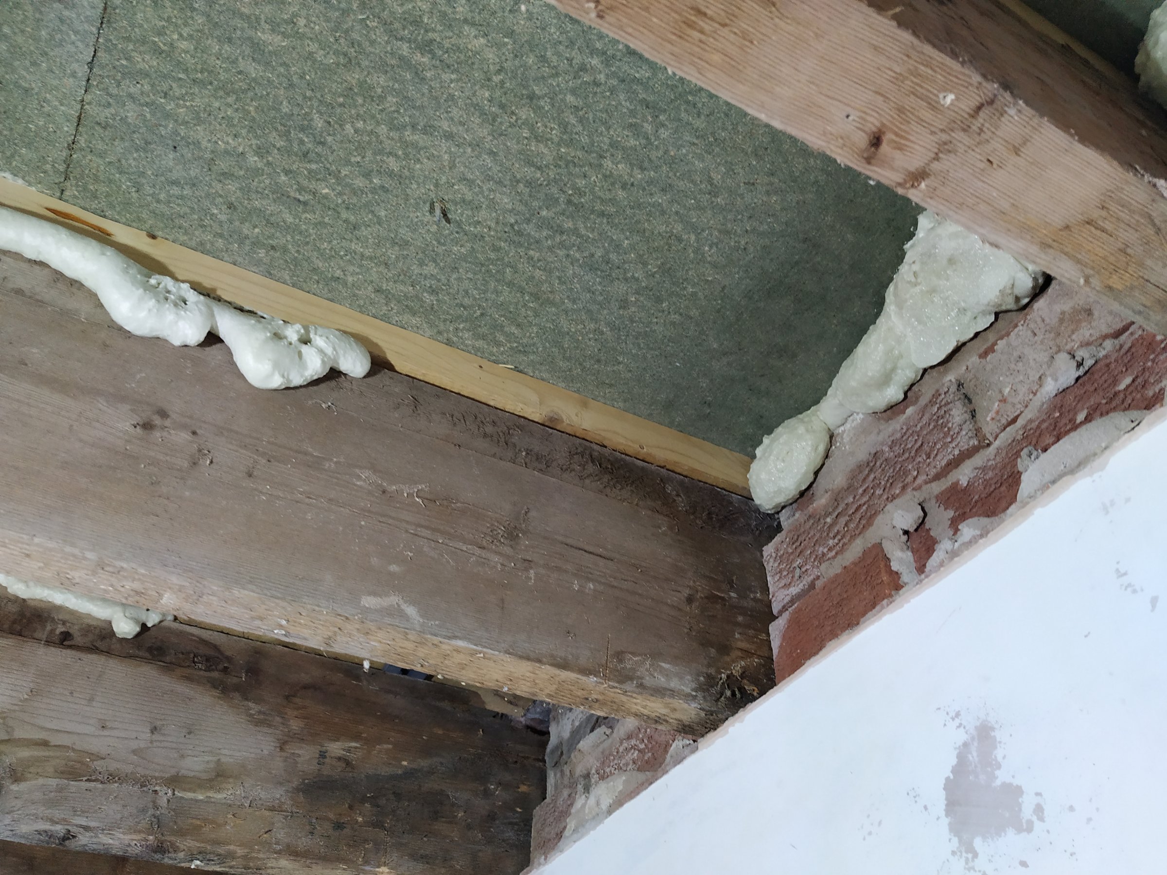

This is the worst joist from below, its not square and is angled over, looking at the bricks and mortar at the end it looks like it may have been like that since installation? Should I remove and try and square it up? Or best left if it's doing its job (kind of)?
This is the opposite ends, which continue on through to the garage, they're sat on a brick wall with the door to the garage going through
What is the best way of assessing the joists to see how much is needed to be cut out? I've been using a screwdriver to look for soft areas, all the end approx 100-150mm are soft, the rest of the joists don't look great but aren't soft. Is there a rule of thumb? IE if a screwdriver cannot be pushed through the timber its deemed OK? Or should I be looking to replace it all due to its appearance?
What is the best/easiest method to sort it all do that I'm not pulling the ceiling down or removing the deck in 5 years time?
Any other info or advice welcome, many thanks for taking the time to read my post:)
They are rotten but are they damp?
If they have dried out they won't get any worse and they may well be enough for the span. They have glued the decking down which would add rigidity and the ceiling below would do the same.
I am in no way expert but first get a damp meter and make sure they have fully dried out everywhere, and then think about sistering or otherwise supporting the deck.

Everything is dry, it's been watertight for over a year and we had 3 dehumidifiers running for a month down there.
I've just been down there again and tested with a sharp blade, although as pictured they dont look great they're mostly solid.

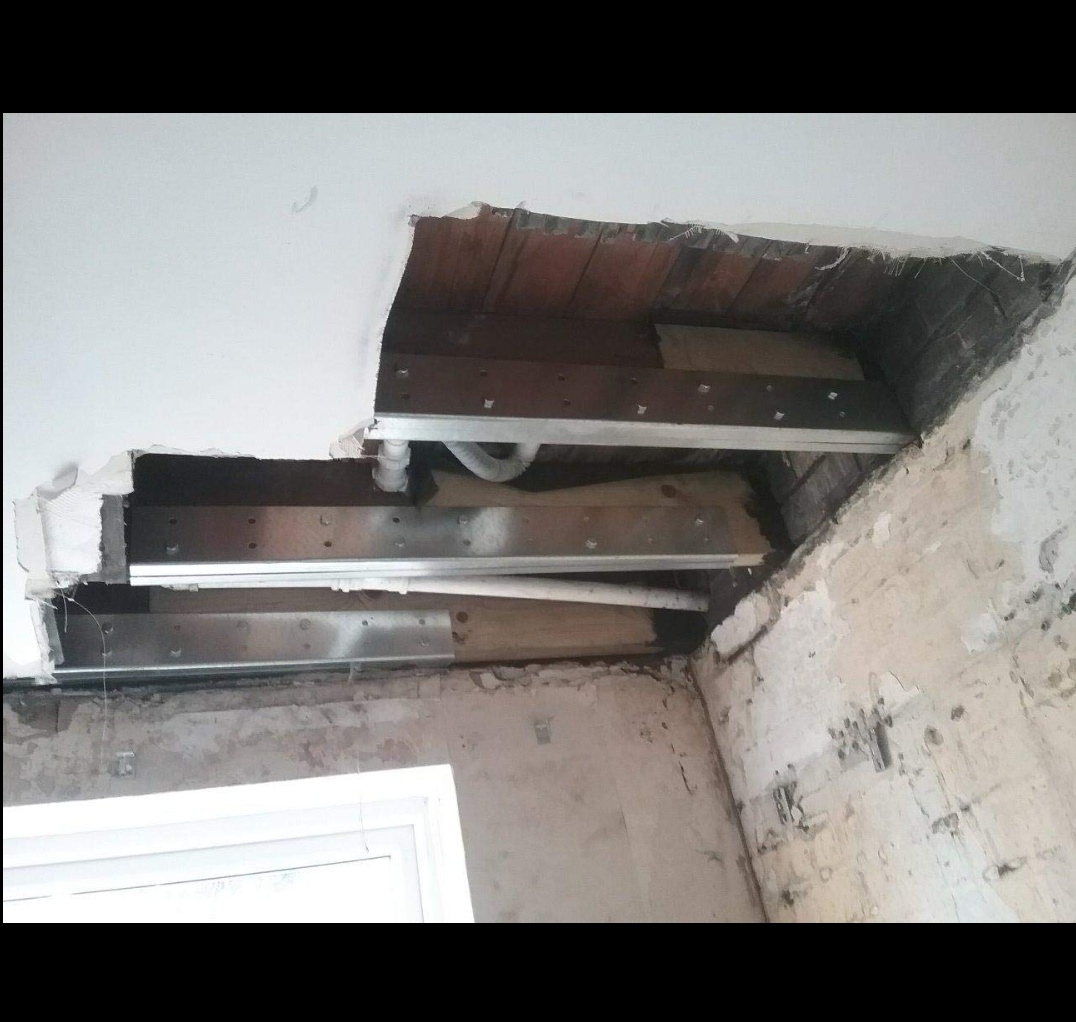

I've seen these BM17 Bower beams which allow for up to 17 inches of removed timber, they'll do the job on all but the worst one.
BM17 Bower Beams Joist Repair Plates (100mm X 1000mm) x 1 Pair Inc. 8 M10 x 40mm Coach Screw Fixings (DELIVERY TO MAINLAND UK ONLY) https://www.amazon.co.uk/dp/B0078L5XV0/ref=cm_sw_r_cp_apa_BXaJBbXRY3K14
One of the reviews however has a pic of a number of them installed to attach a longer length, not sure if this would be an option for me? Or if they're just incorrectly installed?
There definitely more than 17 inches removed anyway.
Or should I be looking at other options for the longer repair?
going to replace all the ends with the BM17 bower beams, they are 1000mm and up to 17 inches can be removed, for the worst one i may replace the end then sister another joist next to it.

The current deck looks terrible and as the neighbour has a sycamore attracts that green growth. Not one of the deck board ends has been cut straight and as they're attached to a floating deck the whole thing rebounds when first stepping on. The work was all done by the same company that left the joists in this state. I used to work away all the time so unfortunately my wife doesn't have the keenest eye to spot any issues!
But that's do far down the line Itll do for now until the rest of the house is done
