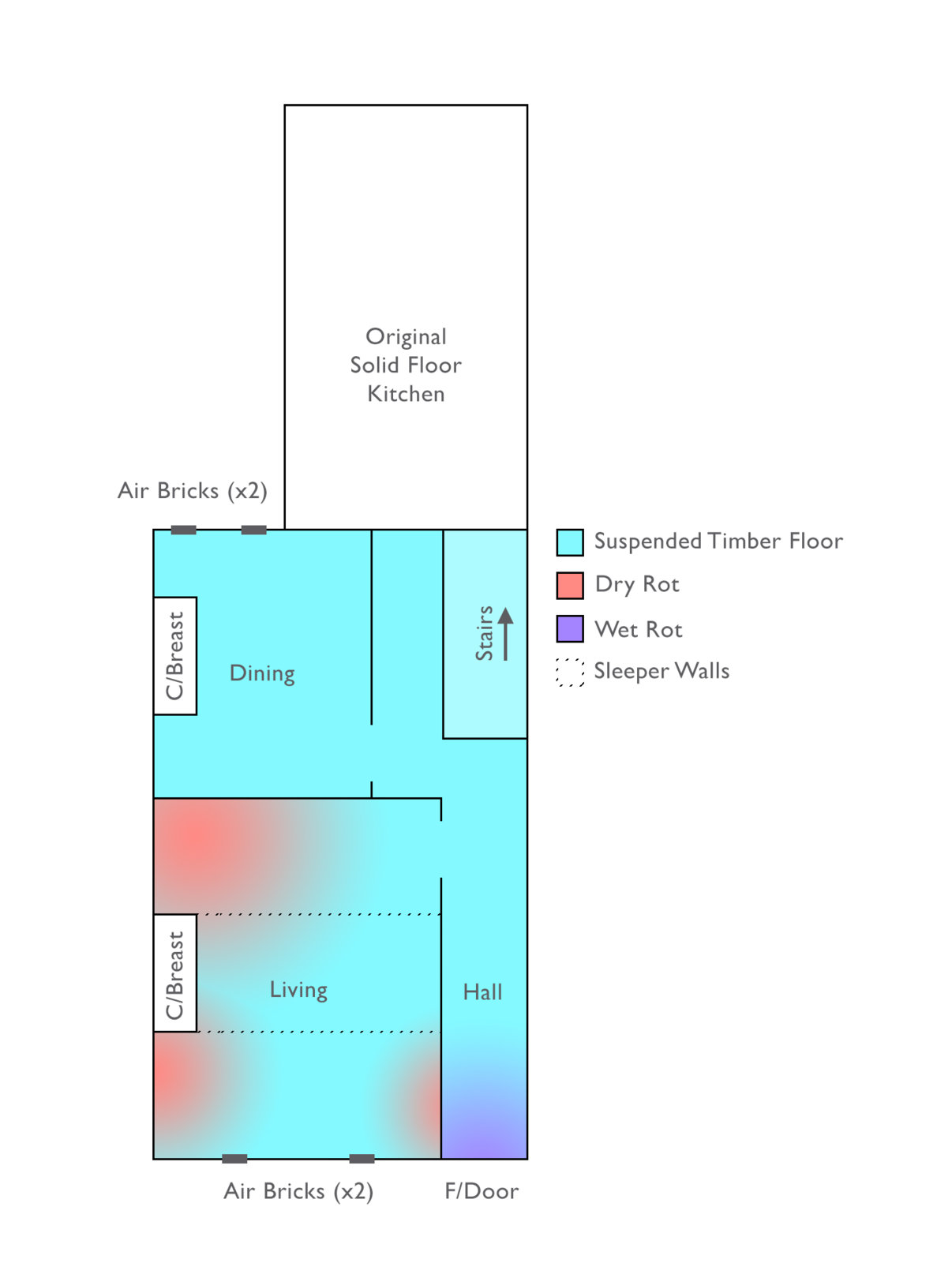

I've recently bought a narrow c.1860 mid-terrace that has significant issues with wet and dry rot to the ground floor, as well as woodworm (all hidden under laminate, with no obvious smells or 'bouncy' floors despite large holes in the floorboards below). The amount of rotten broken wood scraps left under the floor indicate that this isn't a new problem for the house, and that the existing floor (probably Edwardian - 1930s) is at least the second floor to fail.
The air-bricks (just four of them, with not much room to greatly expand their number) are clear.
All of the internal walls are solid right down to the soil, as are the sleeper/dwarf walls, so the only airflow is between the joists and underneath where the internal doors are. Much of the hallway is cut off from the natural airflow completely, with no obvious way of venting it without knocking holes through internal sub-floor walls.
I've done a quick floorplan of the ground floor. The dining room floor is, as yet, unexplored because all the living room furniture had to be piled in there - but I anticipate it'll be a similar state.
The fireplace in the living room has been bricked up - but not vented. Is it possible/probable that this is exacerbating the rot around it, or are they just naturally 'dead' spaces?
Rebuilding the sleeper walls honeycombed would be an obvious way of getting a little more air moving about, but are there any other ways of helping it along without knocking through under the internal walls? Would, for example, a grille vent set into the hallway floor near the front door do much? (There's no risk of radon in this area)

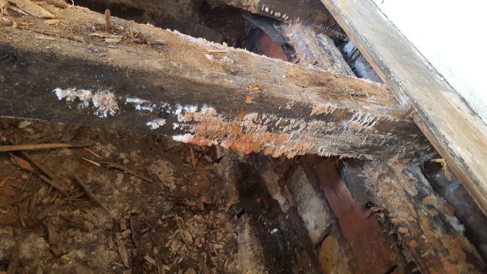

Well, the wispy white fungus covering the joists and board undersides and the small tendrils on the topsides look a lot like dry rot, and the bit that looks like wet rot is just sodden, spongy and crumbly - but, admittedly, I'm not an expert.

whats the photo showing, is it a knee wal with a partition over? the joists have been sistered for repair support and the plate is fungal afected as wellas the jists.

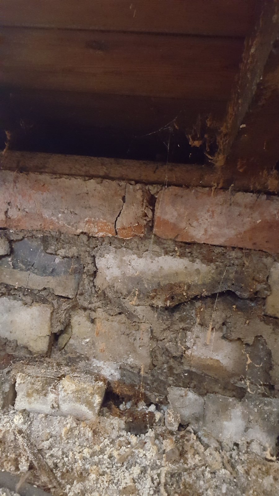

The photograph is the dwarf wall that's built just in front of a solid interior wall (there's a ~15cm gap between the dwarf and the interior wall)

the photo above shows lots ofbeatle frass caught in cobwebs. beatles love damp and lack of ventilation places. i think your problem is lack of strong through ventilation.
