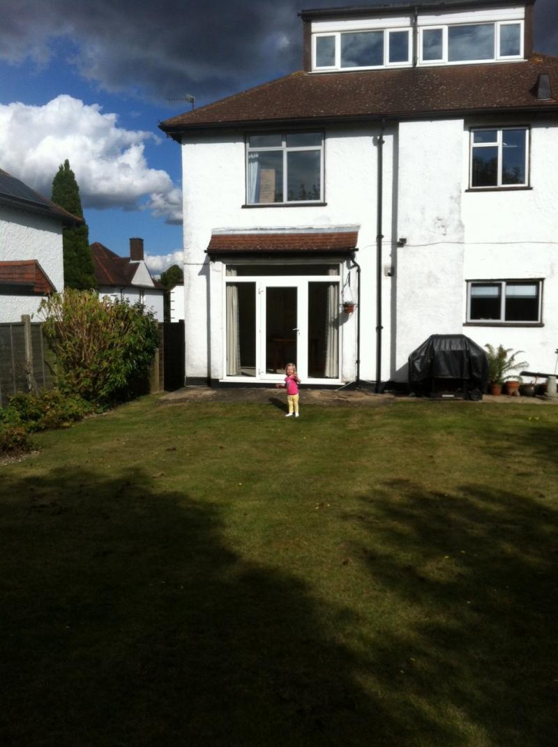

Hi all,
After a bit of advice about what I should expect to pay to have the box dormer removed in the following picture and roof returned to standard construction.
Price for removal of dormer and floor only (all other internal works I can do myself).
Location is Surrey.
Thanks,
Ben
Its the kind of job that we'd do on a day rate, or a hefty price, maybe as above, but i'd be more inclined to price it at £7000 to £8000.
Note:there's very little you could DIY; you cant start pulling down studding or dropping stair flights willy nilly.
The roof would have to be made good, and new rafters inserted.
Is there any steel?
Professionals are not going to allow you to wander around, pulling out bits of this or that, as they work at "demolition" - always a dangerous business.
AAMOI: your c/breast requires venting top and bottom, and the elevation render doesn't look all that clever.
Why is the conversion coming out - Legal, BCO?

Why not? If I just want the dormer box removed but stairs to loft left in-situ (along with hole in ceiling) for me to deal with after the dormer is gone and the roofers are done, why is this not an option? If you saw the conversion maybe you'd think differently - they are the crappest wobbliest most unfit for purpose stairs ever! :eek:

I also thought this. Had a local chap round and he reckoned no need since they are open in to the loft. There are no signs of damp inside the property (well not by the chimneys anyway!). A lot of the render is knackered. That too is on the list. Trying to postpone it until I can afford external insulation (maybe next yr).
None of those. It could stay, but as you can see it's a bit of an eyesore. It's also very badly built. if you look closely you can see little felt hats that poke out of the roof. This is where the wooden beams that support the floor poke out through the roof tiles. Nice!
We moved in about 9 months ago - plan to be here a long time. One of the previous owners was a very bad DIYer - this is one of his constructions. It needs to come down, because it's ugly, the stairs are in the master bedroom, it's preventing me insulating the loft properly and fairly soon it will need a new roof or start leaking. It's too cold in winter and too hot in summer so is not a usable space.
