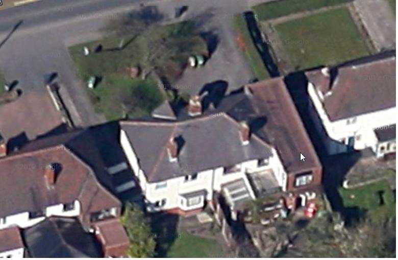

Looking to purchase a property which has had a 2-storey side extension with a flat roof. If I get the house, I would like to replace this with a pitched roof which is tied into the original roof. Would consider putting steels in for a room in the loft at the same time, which would make a loft conversion at a later point easier.
There's no leaks, but it doesn't look the best, plus option for a proper attic room.
Any ideas of rough costs?
Extension is approx 35ft long by 9ft wide.
Thanks in advacne
Picture for reference. The same has been done a few doors down on the left
22k, and your roof oversails unlike next door.
Alot more then what I had in mind
Do you mean the garage sticks out?
The adjacent property has a continuous eave, your extension juts out so would need a more complex frame.
Guess it would need some sort of hipped end on the front, and something similar on the back
If it had a continuous eave all the way around, what would you estimate cost then as?
Offer on house accepted, so this is a job on the to-do list at some point
Had an estimate of 10-12k which included adding steels for the loft floor
Hoping this can be reduced some as well with some planning & homework.
Could anyone estimate roughly how many man days it would take to make & fit the cut roof. Was thinking if getting a carpenter in to do that
I had something similar done but thinking of what mine cost I think 10k is about right. Labour for the roof timbers was 4 days so probably 7 days maximum for that
