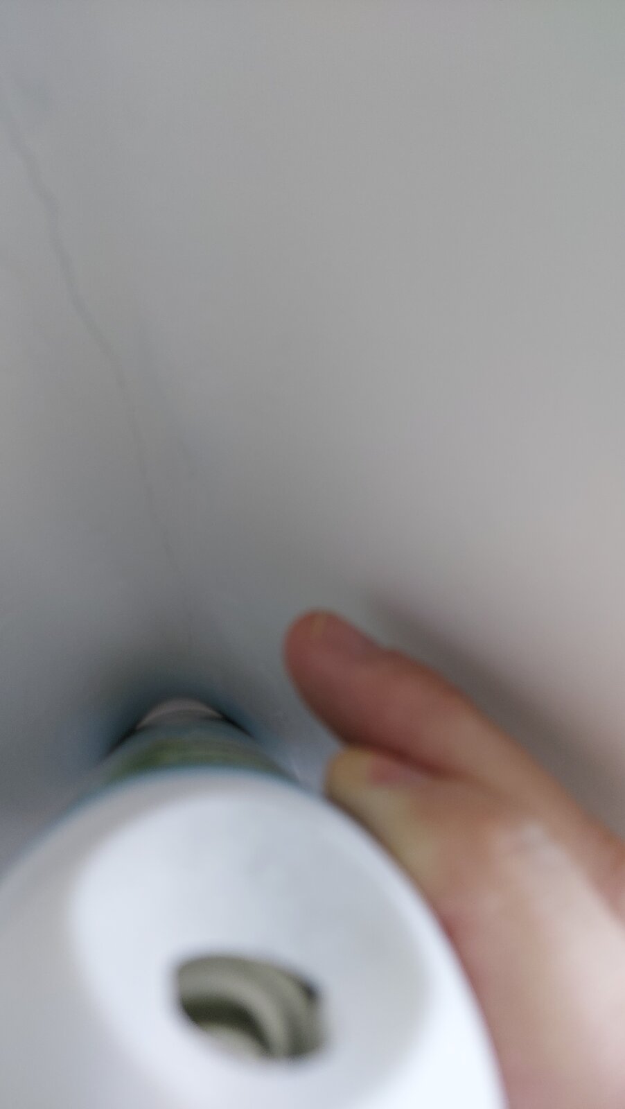

Hi,
I am redecorating a downstairs loo and planning on wallpapering one wall (Large mural type thing)
The corners of the plaster are rounded though. (Internal corners I mean)
How do I go about making these into actual 90deg (..who am I kidding..aprox 90Deg) corners again ?
Is it a case of breaking out the chisel and chipping it out and re-doing the corners?
You need a plasterer to come and fit corner beads over the top and then skim.
I would go down that route if it was external corners to get that nice clean edge , But as this is internal (ie angling away from the inside of the room)..air freshener can for reference I'd hoped to sort this myself.
Is that a really bad idea?
Sorry, missed the fact that it was internal corners.
In which case, yes its about chipping out and remaking the 90 degree corner which sounds like a bitch of a job and something i'd get a plasterer to do :)
Not sure that would work there really.
It's looking like hammer chisel and my dictionary of swear words
