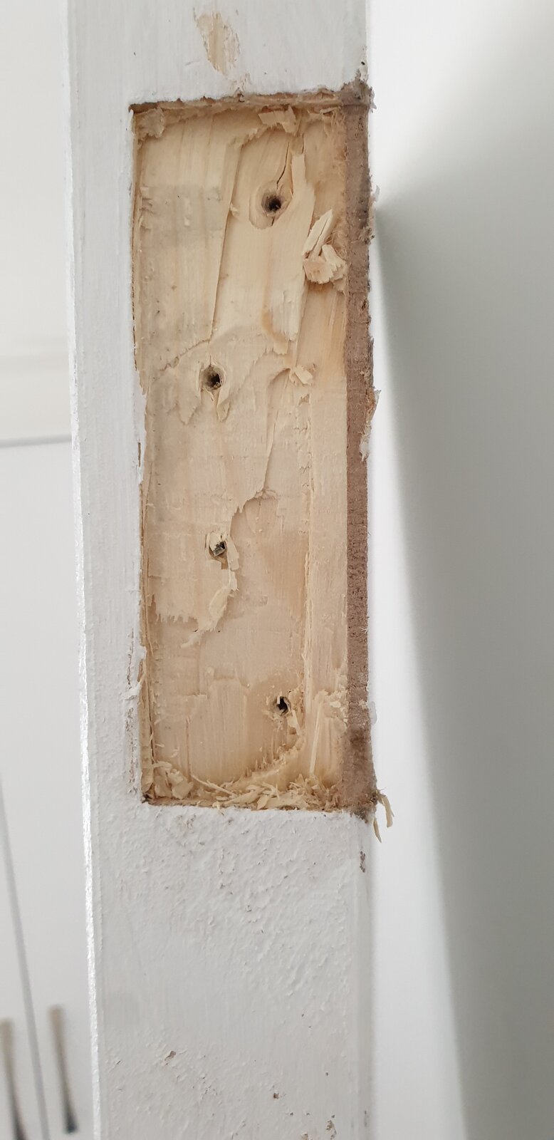

Based on your advice I spent £30 on the Trend cutter from Toolstation. Thank you. It was money well spent. At five doors it worked out to £6 per door. With the first 2 doors I made the mistake of routiing doors that had been taken off. I then discovered that the A hole that fitted them had only left a 2mm gap. I then had to pack the hinges out and plane the lock side, which means I now to reset all of the mortice locks...
The door hanging was shocking. Some of the hinges were so bad that I had to back fill them with 2K filler, a bit of polythene and then let the hinge in before the filler set.
The door stops are retro fitted half inch by 2 inch, the stops are 10mm proud of the frames. It is an effin mess.
And he told me that they, the "builders" had done a good job. So good that I have had to pack out every effing hinge and plane the leading edge and the reset the locks deeper.
I get really pee'd of when I tell someone that I know need to charge them to re-do work that they have paid for, but I am not a charity.
Here is an example of a hinge.
And that wasn't the worst..
That is truly awful. It is also an example of why chisel swingers like me tend to use a router to hog out the majority of the hinge recess to a consistent depth then just finish off with a chisel (that, and it's faster). Sorry, Woody, but I've seen far too many horror stories like that over the years where installation had been done by a "builder"

Yeah, when hanging a significant amount of doors I make a jig and use a tiny makita "laminate" trimmer to set the depth of the hinges. My only other router is an old Dewalt DW625. It does what I need it to, but the dust extraction is pants and I wouldn't feel confident using it on the edge of a door, additionally with the dust extraction "shroud" you cannot see the cutter when using it . I would upgrade but it is a tool that I might only use once a year or less.
