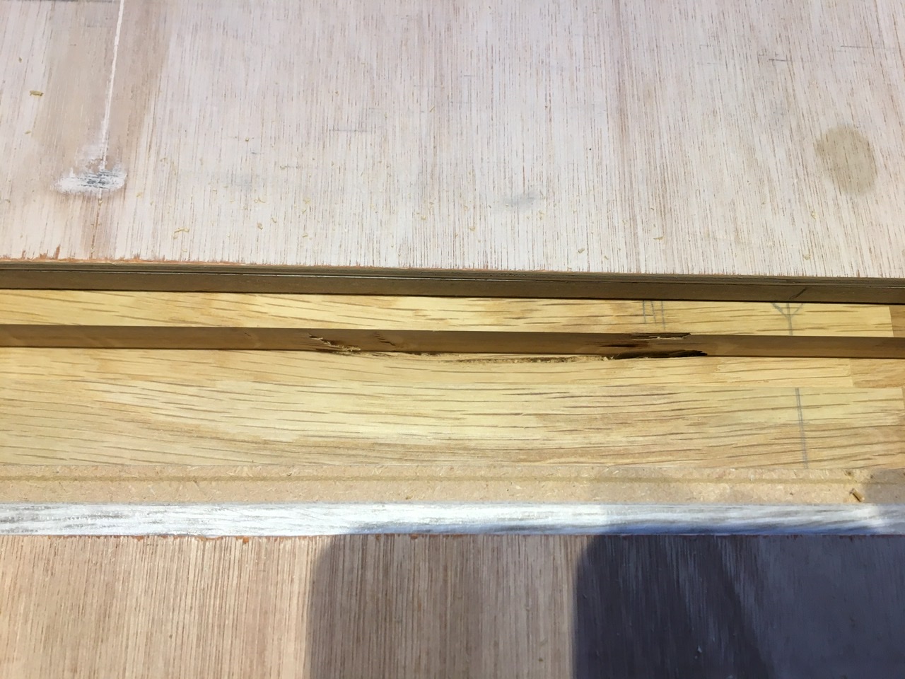

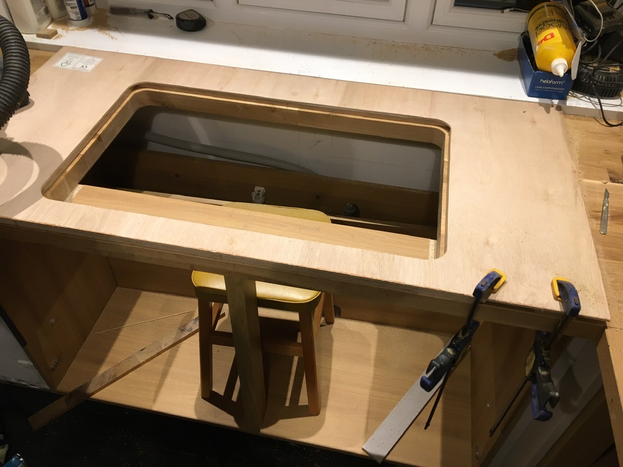

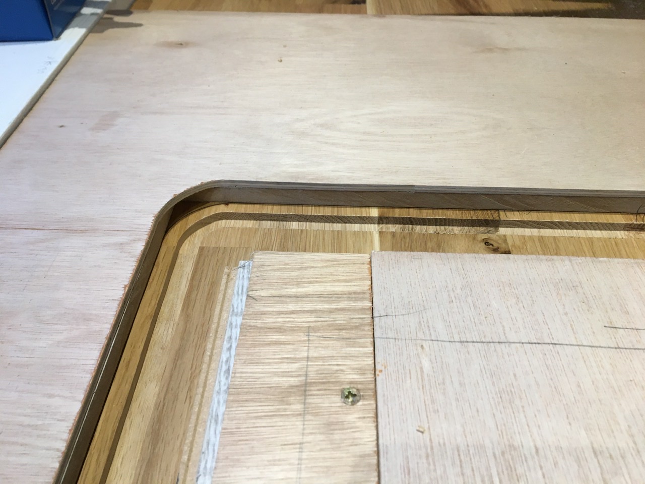

Thanks for that, have routed successfully... kind of. :cautious:
At the edge near the window, there is a bloody split in the wood. When you prod it, there is a slight void behind it.
Franke’s template That was supplied is not that accurate. I think the aperture could be a good few mm larger.
I used a 12.5mm bit with 30mm guide bush. I have a 19mm diameter bit, and I’m 7A049683-066F-410A-9DB9-E1D4968EDACA.jpeg 68D675F6-9894-4C8B-82B5-09FBC181ED5A.jpeg DD1E328A-49E5-4FAA-B0FC-D631E2210D27.jpeg thinking of skimming it again, as I may pass the dodgy split.
To my surprise there is not a scorch mark to be seen, was well chuffed until I saw the split. :cry:
The erbauer bit has been excellent at 17,000 rpm taking 3mm passes.
I silicon sprayed the guide bush and lubed the bit with dry oil.
What would you guys do with the split?
