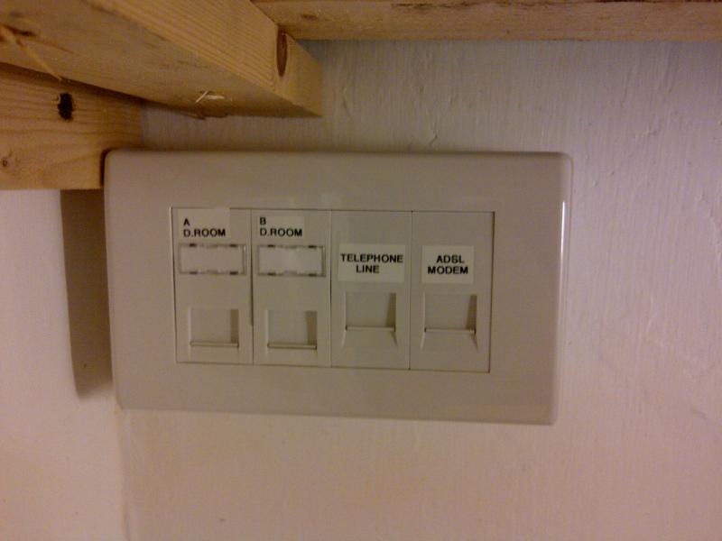

My standard 2G 'patch panel' that I got from screwfix (Image below) is populated with 2x Cat6 and 2x BT are modules that are 25mm x 50mm each.
Hence the hole is 100mm wide and so as you say I could have got 6 of those slimline (6 x 16.65mm=100mm) in my 2G socket (or 3 in a 1G plate). That's great to know for when I want to increase module numbers without installing a new back box.

hi sfk
the slimline sockets are made by excel who are a well respected manufacturer, they are great for adding a couple more skts to a backbox although it needs care re the cable orientation to get all the six cables in
