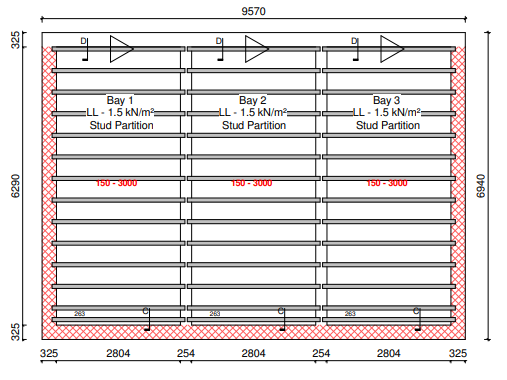

Drawing as above for the B&B design.

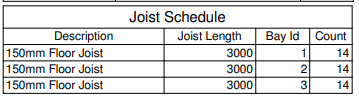

Concrete Joist Schedule:
Spec from SE:
"Beam 3 and 4 254x254x89UC
Supporting new 150mm thick beam and block floor"

Normally you get some drawings to approve from the B/B supplier, as mentioned depends on what's been specified/required etc, no designers details then? Why is it suspended out of interest?
Drawing appears to show block & beam floor on top of steel beam rather than resting on bottom flange.
What does section C-C and D-D show?
It does though the beams might be sitting in the webs, it's not a very clear drawing, c or d won't be any good he needs a section the orher way.

This is what we got back from the B&B supplier this morning.
"You have two options:
  • Run a course of brick on the inside of the steel to raise the beam and block up.
  • Introduce a shelf angle to the inside of the steel (Either welded or bolted), to raise the beam and block up by 100mm."
I am due to speak to the SE later this PM.
Depending on situation the concrete beams can be installed on top of within the web of the steel.
On top would be the easier and cheaper option.
A shelf angle fitted to the web of the steel beam would be my choice if the concrete beams need to go in the web of the steel.
