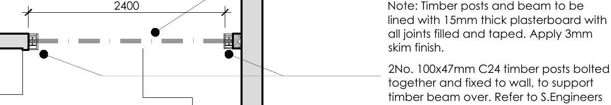

There are a lot of architect's drawings with some beams to be installed (with dimensions, etc.)

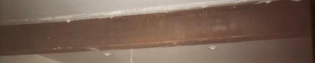

Unfortunately the only 'proof' related to the kitchen wall is the bad quality picture attached which does look concerning in my opinion.
At least on the left side there doesn't seem to be much support for this steel beam.
While the picture quality is really bad, I would really appreciate your opinion about this work.

When was the work done, can you post a pic of the drawings showing the beams? Any obvious cracks or similar around the area? Yes those pics are crap.
The work was done in 2016, and according to the plans the beam should be
2No C24 250x47mm timbers bolted together.
I can't post the full drawings, but the one related to the kitchen wall is attached.

Well who knows, the photos really are useless, is there a nib on the external wall where the two timber posts should be? Do you have the structural engineers drawings as sometimes architects plans don't show the correct structure. If the work was done in 2016 then any problems would have likely become apparent by now. Was the fire escape from the first floor compromised in anyway? An overall floor plan would help.

So is there a nib and do you have access to the structural drawings? An unapproved beam is pretty common on many house purchases, if there are no cracks or other issues it's probably OK, my last house had an unapproved knock through, it didn't bother me, or the next buyer.

I only have access to the architect's drawings.
I don't think there is a nib on the external wall, I have a single picture of that wall and it looks clean.

But I can't say that the work has been done according to the standards, and neither a structural surveyor without opening up the walls.
Well if there hasn't been any significant movement in 7yrs then that's a good sign! as long as it doesn't look like there has been some touching up prior to being put on the market of course...
