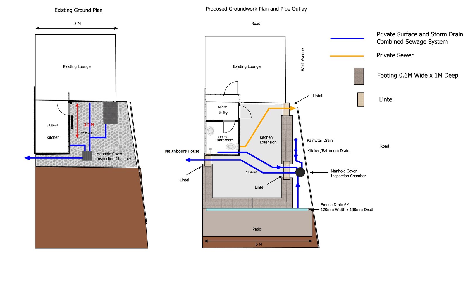

Trying to cut costs I am myself project managing my ground level single floor wrap around kitchen extension. It's a fairly simple design, no walls are being knocked down.
I have Planning Permission and am now working on the Building Control Plans.
We intend to install bifold doors to stretch over approx 5 meter wall to wall, at the front of the extension. To do this I proposed having a RJS over the doors and spanning the two side walls, then cover the extension with a King Post design roof. Please the the images below.
My question is for Building Regulations approval would I need engineering calculations for this part of the project? Or are there other options?

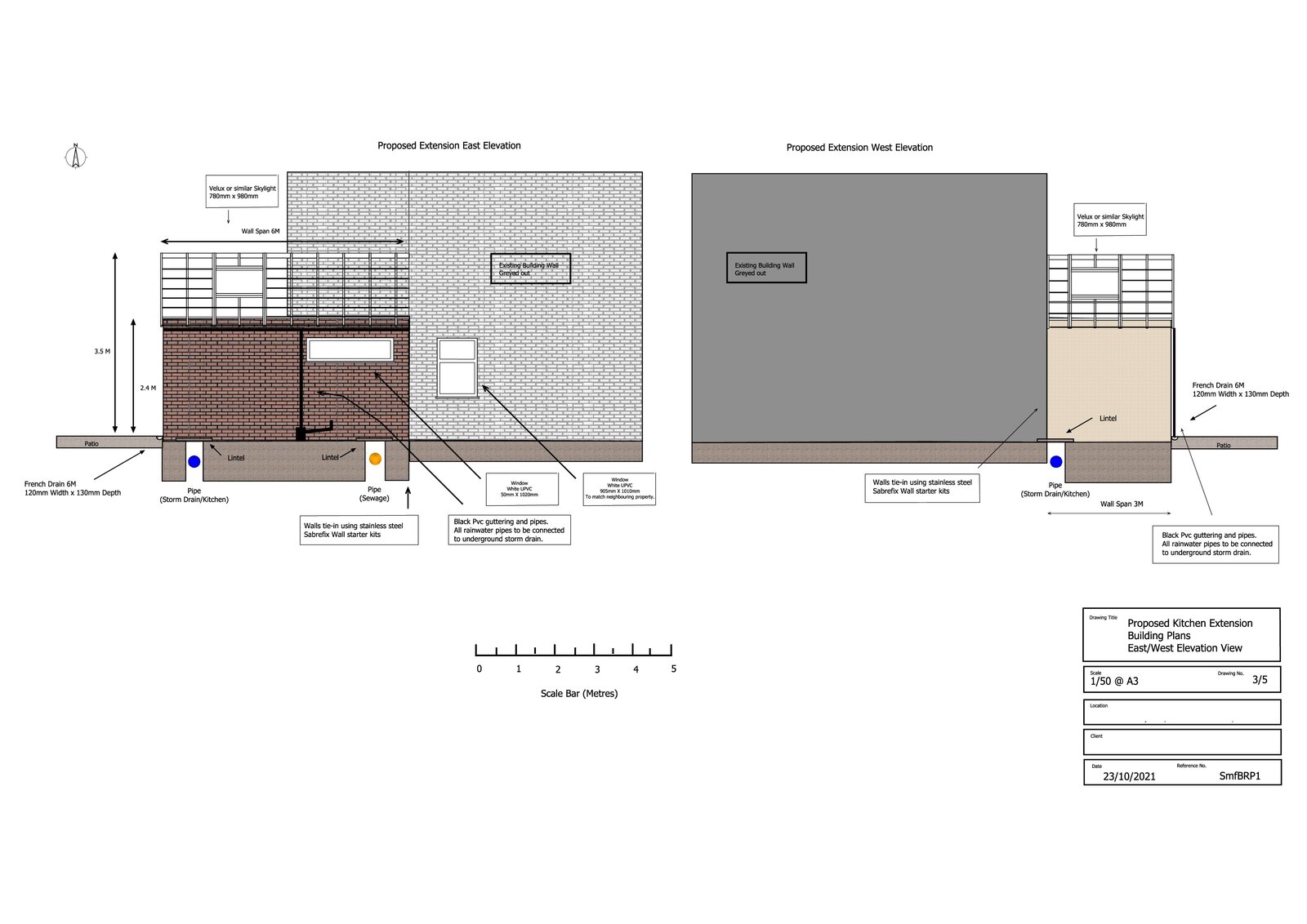

A couple of things from looking at your drawings -
The masonry reveals either side of the bi-fold are too short and don't meet building regs.

You will need to justify buttressing of the return piers regardless, unless they are 665mm.
Your section drawing is confusing. You would not see the beam or padstones in that section view. It looks like you have another beam and overhanging padstones somewhere else.
Your detail of the drain and foundation is wrong. Foundations should go under and bridged over any drain at that depth. And if its a public sewer, you need your water company's permission before applying to building control
Your reference to wall span and roof span are contradictory - roof span is an internal dimension, and there is no such thing as wall span in this context - its just "width" which is an external dimension, but you would not mention width, just dimension it - and the arrow does not go to the end on the left, BTW - it look like it goes to the internal face.
I don't know what the last drawing is showing as the blue pipe seems to be in a different place compared to the other views
You should label the views
Don't draw horizontal battens on rafter section views. That implies a different roof system.
You wouldn't want a padstone showing on the outside - that would look naff against the brickwork; you would have the bearing of the beam long enough so as not to need a padstone.
You don't need 15mm 'fireproof' plasterboard - standard 9.5mm will do.

Yes that section view is confusing will delete that one and keep 1st cross section and completed view only. The pad stones won't be on show.
Will follow your advice on roof battens, editing the referencing and arrows on the drawing and increase return piers to 665mm.

I'm not to clear on your advice regarding the drains though.
The blue pipe is a combined drain (rain water and dirty kitchen/bathroom water, old original pipes). It is at clay level aprox 90cm down from original house DPC.
The yellow pipe is a separate raw sewage toilet drain, can't see manhole for that (same for all houses on our terrace btw). Are you saying there should be no gaps in the footings? The concrete should flow completely around and under the pipes?
The rear section view shows a blue pipe passing through both foundations
The last but one side view shows a blue pipe near the outer edge of the extension
The last view (presumably a 180° flip of the view next to it) shows a blue pipe near the house, not the where it is shown on the view next to it
You also say the pipe is about 90cm down from DPC, but on the drawing it looks a lot higher up. You should really show it at the correct depth as that will determine how the pipe is bridged and the foundation detailed around it. Otherwise the inspector will question it, and you will say "oh the drain is really deeper than that"
And you would be wise to show the existing house foundations deeper, to avoid the inspector questioning that, and avoid PW Act issues.

Thanks woody,
Yes your right, I have to edit the underground drainage part of the drawings. I've uploaded a drawing I made for my reference and will follow your advice. Our house is an end of terrace semi.

As for the drains, you really need to be drawing them as straight lines between the points, not with loads of bends like that. Also, have you confirmed that your council will allow new rainwater and surface water connections to the existing system?
Thanks woody,
Will confirm with lintel manufacturer.
Yes, it is strange, I wondered about it. All the houses on our terrace seem to have the same drainage system and we're first on that combined drain. I've dug out this drain to have a close look. It looks like at some stage in the past (decades) bath and kitchen water was diverted into the storm drain along the whole street! I will check with council though, maybe I will have to redivert to the foul main sewer.
