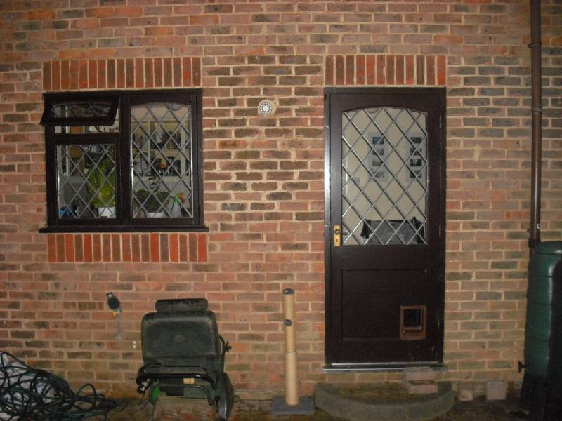

I am after wisdom on an external wall....
House is 1987 Link-Detached will block inside and brick external walls. Kitchen has a standard door with small wall then window. I wish to remove this wall extend the window and suppport all with a RSJ or Lintel... gap would span 2.6m. What would be difference between the two? Also any ideas on costs or days one/two/three builders I can expect....As always really appreciate assistance....
between the door and window looks about 3m so you would need a 3.5 catnic lintol to do this, would take 2 men about 2 days to complete with plastering, not sure on cost as rates vary all over the country but the lintol would be £200-300

I will be rebricking from the left so I have a 1800 window & 750 door, so added bit for frame. Is there a difference between RSJ & Lintel....costs, strength, installing??? etc etc??? Struggling to get builder to arrive for a quote let lone start the job!!!!

A lintel will be far easier as it is designed to support a cavity wall, using an RSJ will be daft as it would sit under the bricks and you'd have to hide it on the outside. Only way to get costs is to get quotes, despite how dificult that may be.

I can see how a "H" Lintel would support when in place, does a standard "Cougar" lintel only work on fresh installs? What style am I needing when knocking through a wall. It is external bricks with block intenal, supporting floor, masonary and roof. Gap I have measured to be 2.7m am think happy over engineer so 3100mm wide.

You need a lintel that looks like an upside-down T, and of a width suitable for your cavity size, which will be 50mm from 1987. These tend to be easier to install
If using a Catnic brand, then this will be in the shape of a boot - with a box section internally and a thinner section on the outer edge to hold the external bricks
If using a lintel, its very important to support the centre section during install and untill the bricks you replace have gone off. Otherwise it will bow
If you use an RSJ on the inside, then you need a L shape lintel for the external bricks
Hi monkeysdiy, yes you can use a standard "Cougar" (CG) style lintel for your opening. Like this:-
Something like a CG70/100 or CG90/100 will probably be ok but you need to specify the cavity width and get a lintel to suit. Hopefully Shy will confirm for you or you can contact Catnic.

My cavity is 85mm (no pun intended)
Everything I see illustration wise shows a "H" install......
Do I support everything then....
:arrow: Remove3 courses above gap
:arrow: Install Catnic Lintels level on padstows either end securing with mortar. Allow 24hrs to set
:arrow: Install soldier course upto existing brick work ensuring gaps filled with mortar. Allow 24hrs to set
:arrow: Remove props, cross fingers and spend night in hotel?????

These lintels bow as the bricks are re-inserted and load added to the lip. And as the bricks are tapped, the lip vibrates and mortar compacts and the bricks tip forward.
I'm forever seeing the soldiers or first three couses above lintels (new build and replacement) tipping out, and the lintels bowing, when clueless brickies haven't bothered to support the lintel during construction.
You don't need padstones for lintels in this instance

So the Lintel "Mater" provided pic of... just sits on existing brickwork with small mortar bed to the tune of 150mm plus
Regarding my install steps.... am I correct plus keep a support to prevent bowing...
Once the brickwork has gone off, then there is no bowing, as the wall has an element of self-support from compression of the hardened mortar joints
