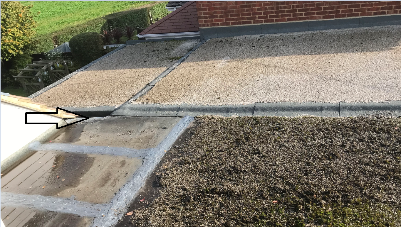

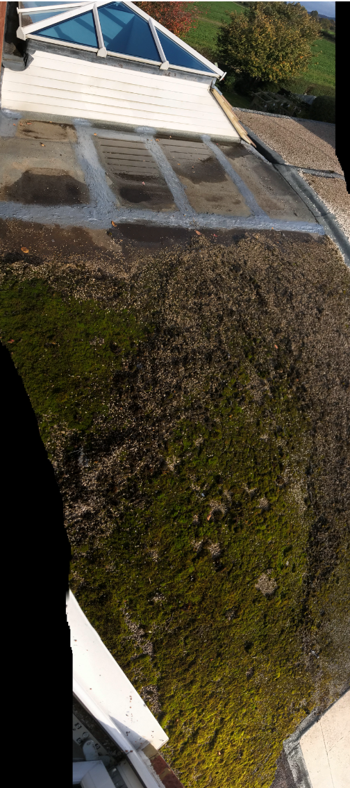

I am planning a project to replace the current felt roof on my garage with a rubber roof. As part of this, I am planning to replace the PSB Boards too. I need a bunch of advice please:
1. How easy/difficult will it be to lay OSB Boards across this space to level it in a way that all the water heads to my gutter at the back?
Here are some pics.
The left side joins to the house. The right side joins to the neighbours garage (felt roof - recently replaced). The back of the garage joins to my extension.
My drain is where the arrow is pointing and ideally, I would like to divert all the rain water here:

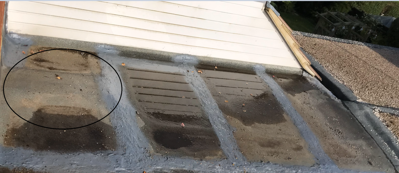

It's not very easy to see but this part of raised as there is an RSJ under here. I was hoping to raise the OSB boards along this side of the wall to create a slope for water anyhow.

Is the roof already pitched slightly to the drainage edge? If yes there's likely nothing or very little needing done in that regard assuming the underlying roof construction is still sound and sufficiently pitched.
