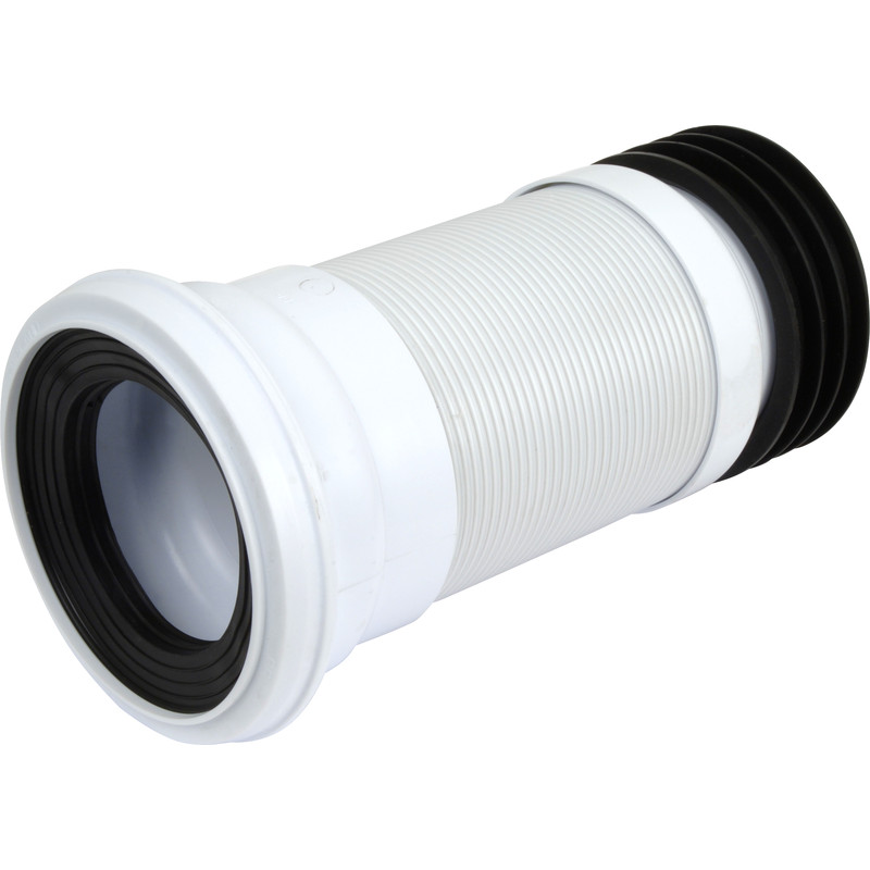

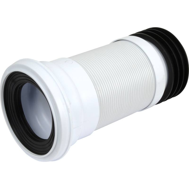

PS: if I decide to replace the pan connector with https://www.toolstation.com/straight-pan-connector/p19642 , is this just a matter of cutting off the old one and inserting the new one? i.e. no need for anything else such as glue etc...?

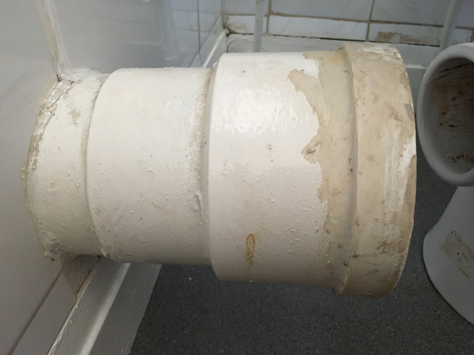

A pic of your pan connector would be useful

I will post a photo of the pan connector as soon as I can, it looks like I will have to cut the front bit with a saw...
Why do you need to cut the front bit with a saw? , it should just pull off
It is a solvent welded pan connector, I cannot remove it. If I cut it at the base, I won’t have enough pipe to fit a push-in pan connector as it would be to close to the wall. Can a solvent welded pipe be cut along the length and then removed?
Cut it flush with the wall and fit a Multikwik extension "A". You can then cut this to the correct length and fit a normal wc connector.
Thanks, that’s interesting, I never heard from those Multikwik extension "A", are those reliable? Can’t find them from Screwfix nor Toolstation, will need to order online...
denso beat me to it.
Yeah, cut soil pipe flush with wall tile and use an extension like a polypipe 200mm straight extension with a straight WC pan connector (or offset WC connector if its needed).
Measure the height of your wc spigot invert from the floor and the measurement from the cut flush, wall soil pipe invert to the floor. Hopefully they are about the same.
There not , when there are better connectors use them , an offset one if you need it is a better choice
