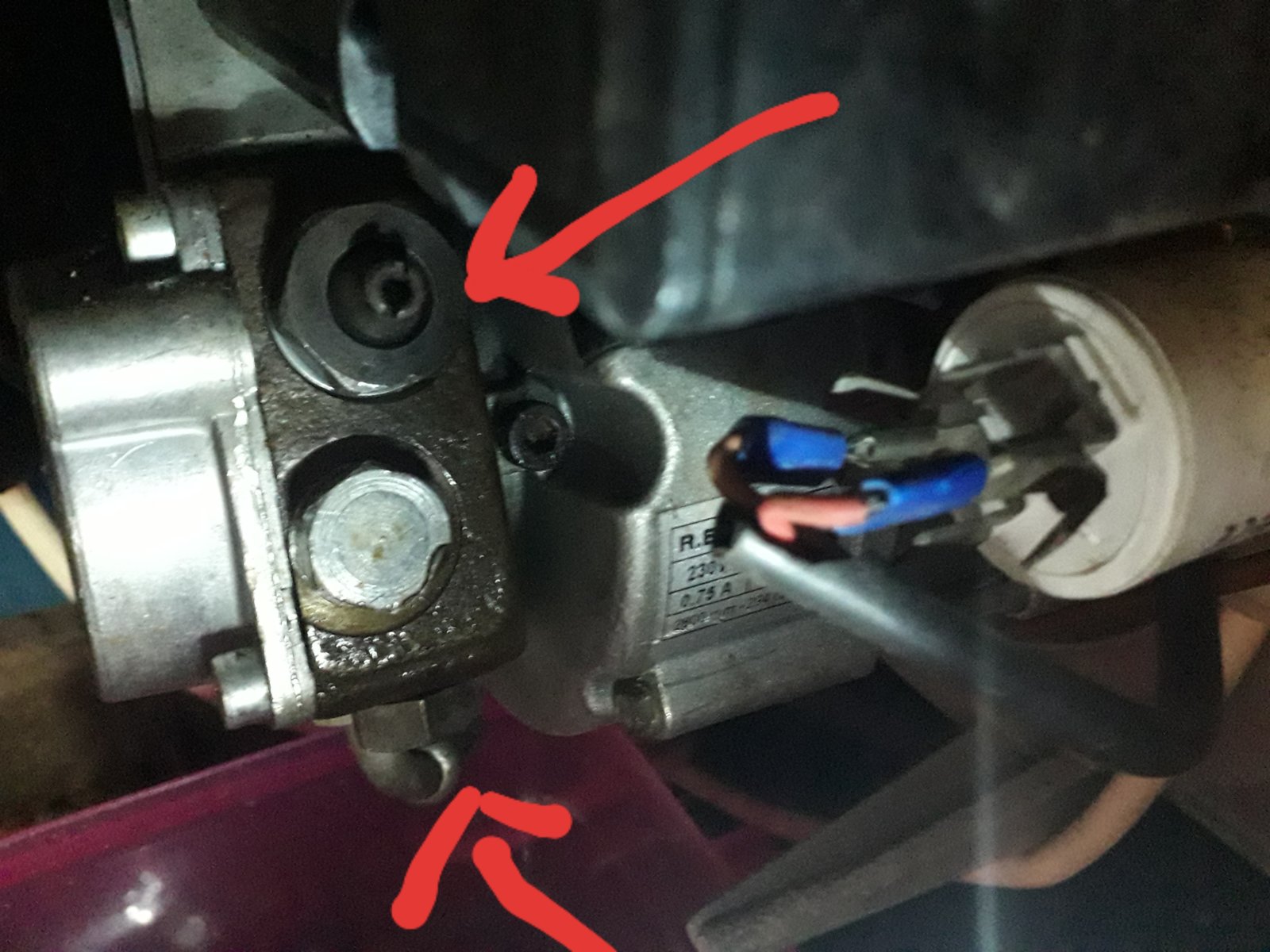

Help stupidly ran out of oil. Which nut do I use to bleed the pump? If any of these
Do not move the top one.
the bottom one but it should have an extension bar with a nipple on it to attach a pressure guage. Where has that gone ?
