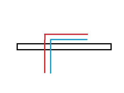

I'm going to run some pipes in a suspended timber floor (depth of joists approx 200mm+).
I've read in my plumbing book that the notches should be made no closer to the joist supports than 0.07 times the span on the joists. or further than a quarter of the length of the joist away.. I don't understand this...
The joists sit into the wall (this is a Victorian house) so are these supports?
A friend has told me to run the pipes as close to the wall as possible, and I have four pipes to run (flow and return for the central heating), and directly hot and cold to appliances.
Any help appreciated
Thanks chap.
Do you think I could get away with running four pipes like this side by side ? Or running them in pairs exactly as indicated in the diagram ?
My next question is as I am using speedfit plastic pipe below the floor how do I cope with the elbows? As these are big chunky things
I want them to be clipped properly but it appears one will have to run out much beyond the other at right angles and will be difficult to clip
Thanks chap.
You drill holes for speedfit thats the point of it being flexiable
Just follow the diagram just to comply, thats problem with plastics they are bulky, you can use compression fittings and dont forget a plastic cutter and inserts
