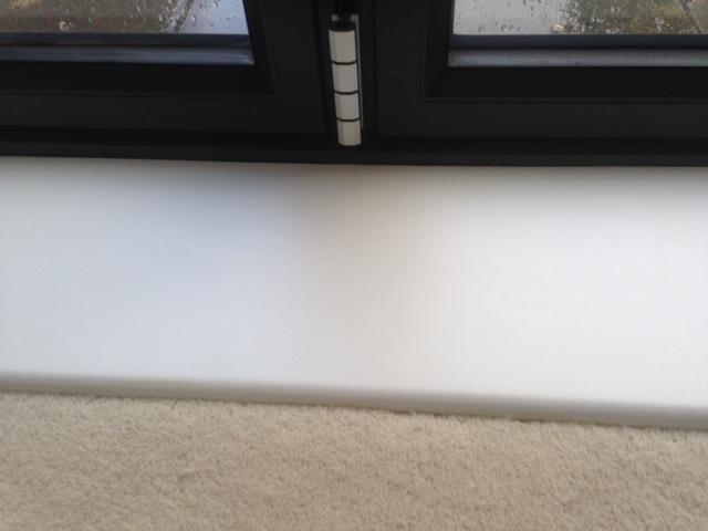

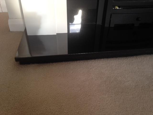

Hi,
I am soon going to rip up my carpet and underlay and fit engineered flooring. I am fitting new skirting board so I happy with leaving an expansion gap and hiding with the boards.
How would you finish the edge off where skirting boards aren't used?

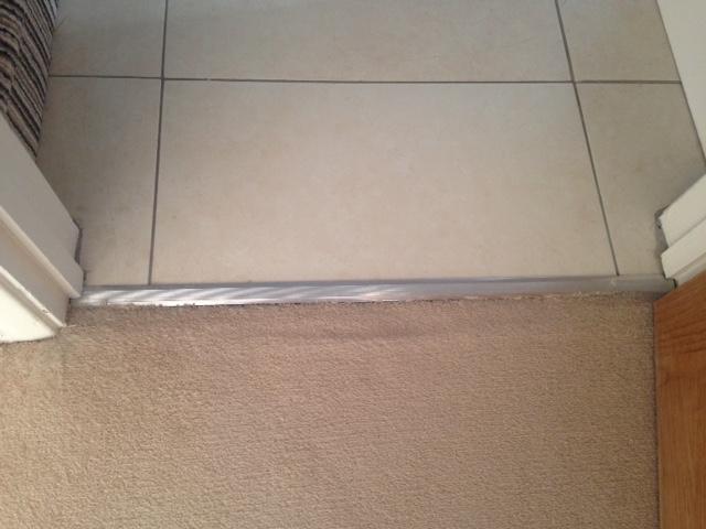

Also... two of the thresholds go to a metal door bar with tiles in the other room. e.g. currently carpet to tile but being replaced with engineered to ceramic tiles. As the bar is already fitted and I guess the tile adhesive will have grabbed the door bar... how would you replace this?

You want to use a Sqaure edge wood trim around fireplace and a T shape edge where ceramics are
When you say Square edge and T shape edging, what do you mean and how would you suggest fitting it? I won't be able to nail/tack it as it's a concrete floor. This would also defeat the object of having the "expansion gap" so I'm guessing there must be a solution to hold it in place?

You glue them down with no nails or similar. I use flexy fix
The door bars have a lip on there for the expansion.
If you call in a wood shop you will see them
