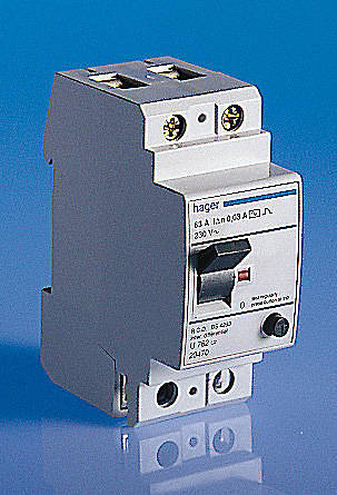

I will be building a pond in my garden soon and I need an electricity supply to power the pump, uv filter, lighting etc. I will be using SWA cable buried under my patio (500mm deep with hazard tape). I plan to connect to the mains using RCD then plug.
So the circuit you plan to use is not already RCD protected?
then plug.
You can't terminate SWA in a plug. And why a plug, anyway? Why not a switched FCU?

There are some plugs which will take SWA cable but these do not include the standard 13A type so to terminate it will require a box. Likely the same box as you intend to use for the RCD. However assuming at a later date you may want to put whole house on RCD protection then using a 10ma type for pond would make sense and one has to be careful on type used as the price will vary a lot. I used a metal clad 10ma RCD socket as it was in my spares box and a metal clad socket box with stuffing gland to change from flex to SWA not best but what I had to hand at the time.
I was going to terminate the SWA at the RCD using a gland, if it will take it. If not I would use a junction box.
