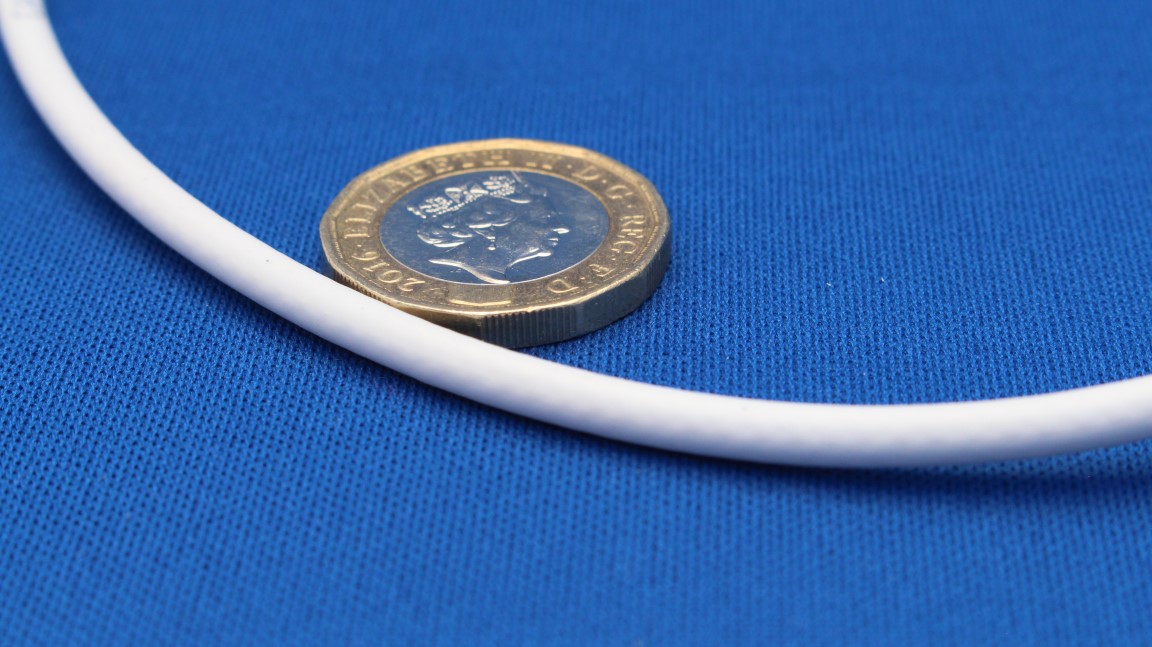

There's a mini coax lead sold on Amazon that I have used in the past. It's only the same thickness as the thickness of a Pound coin yet incredibly-well shielded and very flexible.
At first sight it looks pricey compeared to the average sub lead, but it's built miles better and half the price of a similar product from QED.

I pinched an image from when they were listed on Ebay.
Edit to add: The 5m version here with reviews 5m Super-thin 'hum killer' install 75 Ohm subwoofer: Amazon.co.uk: Electronics
