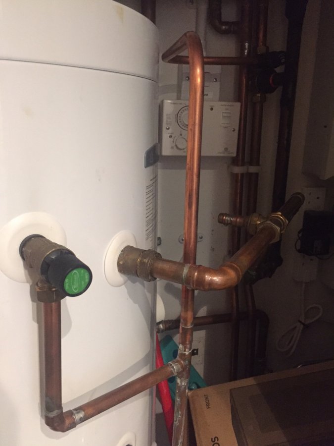

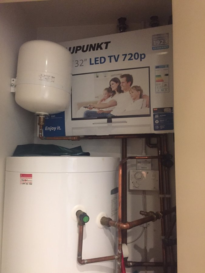

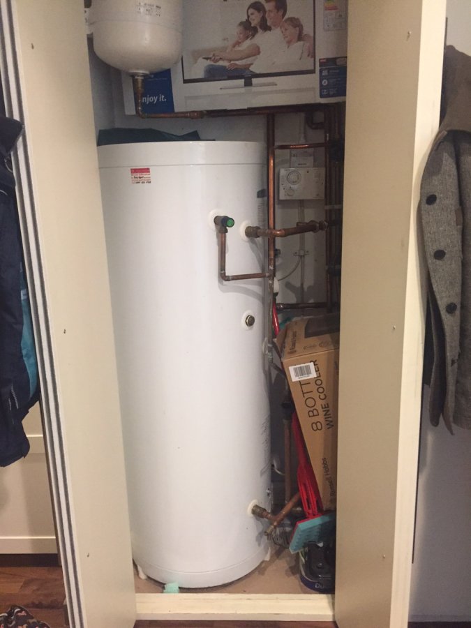

Hi a photo of the offending unit would help in giving advice if its a megaflow the air gap would need regenerating .

Hi, here's some pictures.

Hi Henry this air bleed you let the air out of was it on top of the little white cylinder at the top ? If so you nee to get a plumber with unvented ticket to refill the pre charge on the expansion vessel as there won't be any now.
Cheers Mark

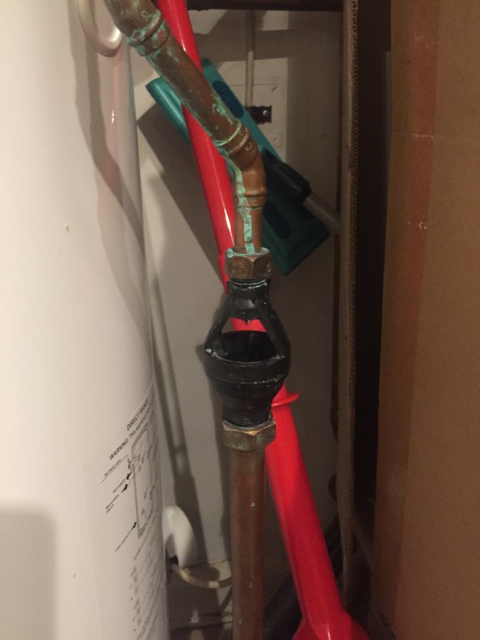

Hi Mark, thank you for your reply. No, I simply turned the green knob connected on the larger tank. The air came out, with some water, from that opening (see picture)
