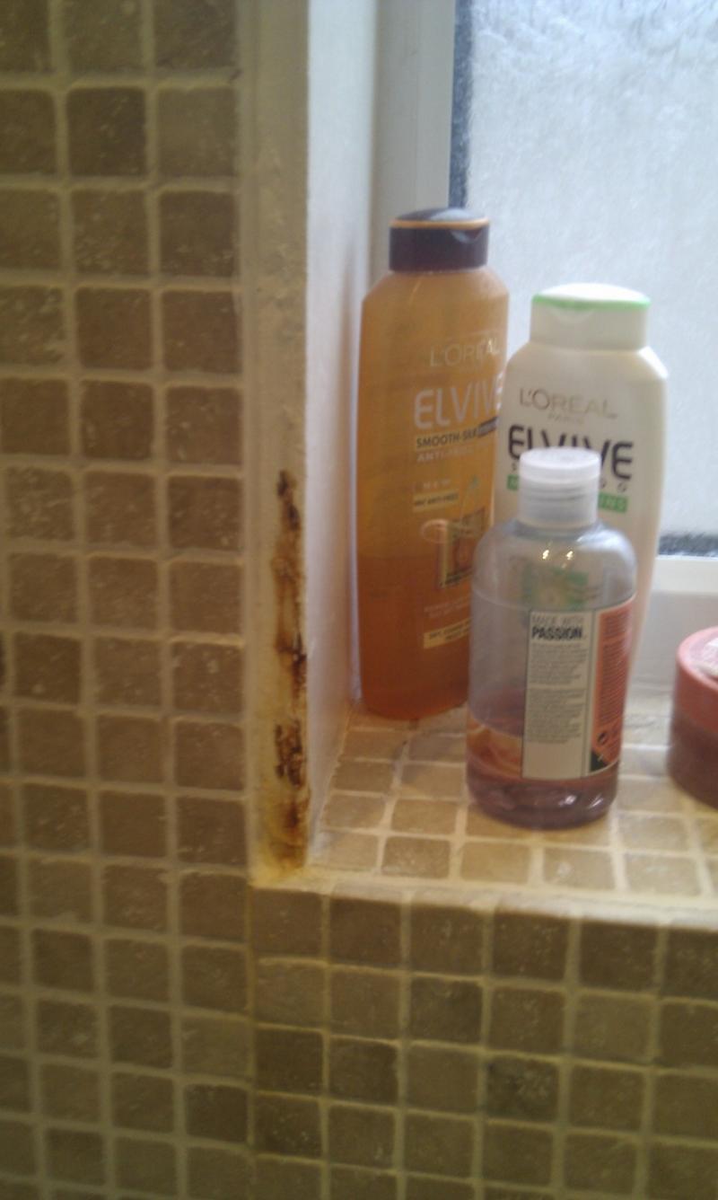

I have been having this weird rust type staining developing on my shower wall (constantly exposed to water when showering). The wall appears to be solid brick wall (not metal), so how can rust develop on a brick wall? (see attached).
Any help on how to fix this would be very appreciated. Would just painting with mould type resistant paint on it work?

You have a metal skim bead on the corner, It keeps the shape of the edge.
Krust metal treatment, and some metal place.
or, cut out the skim bead and replace with some new stuff.
A
The wall has galvanised steel plasterers beading under the surface to help give a strong edge to the plaster. If you keep it wet it will rust.
Having a wet wall is generally bad practice anyway, since the plaster will fall off, you will also get rot, mould and mildew.
When you are dealing with these problems, and the plaster and tiles have fallen off, you can use stainless beading during your rebuild.
For a start you could fit an effective extractor fan, and use it. You could also tile over those parts of the wall that get wet.

Thanks mate. What do you mean by metal place?
What should I do after applying kurust?
well, he could - sort of ;) in fact he could get some plastic cladding/ facia with a L shape and a 20mm return - then line the window reveals with that each side - covering the dodgy bead and up against the mosaic tiles :idea: Shepherds in Eastbourne do loads of uPVC mouldings - Lottbridge Drove
I'd take the rusting bead off, replace it, then replaster/tile the areas that are continualy wet.
