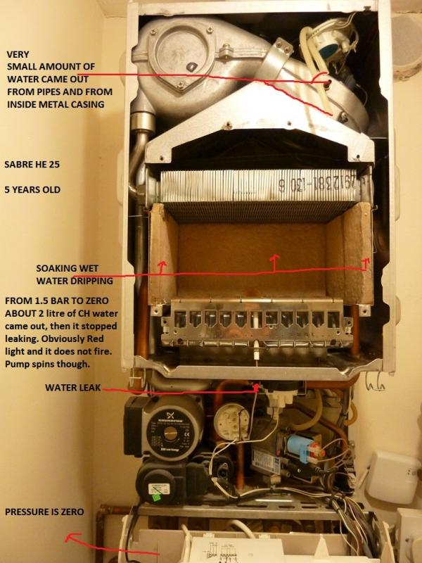

Hi,
My 5 year old Sabre HE 25 combi is leaking water. I have attached the picture.
Not pouring out, but it is leaking.
Pressure drops from 1.5 bar to zero bar fairly quick, hence the red light comes on and it does not fire.
The water comes out from the drain pipe under burner.
Pressure gage reads ZERO bar.
Heat insulation blocks, all 3 around the burner is soaking wet from top to bottom.
Also, after it drained itself, I have disconnected the two venture pipes (at the top) small drops of water came out from the pipes and from inside the metal casing.
What is wrong with my combi boiler?

Condenser unit leaking at top of boiler! part cost over £300 better of booking a chargeable call with vokera, should be ok unless more parts required as they have a limit upto £450 worth of parts hope this helps.

You are spot on John! Engineer find Condensing Unit faulty (345+vaT= £414.00)
He reckons, also 2 other parts needs changing (plastic over flow unit and did not say the third as he was not very friendly person at all) totalling £451,95 little over Vokera limit.
He also said that the other parts may be damaged by water leak and advised me to get a new boiler.
I can see his point, however electronics are well hidden under cover they look dry and combi was trying to fire even with water leak.
