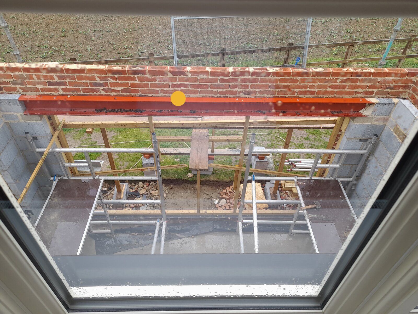

I am adding a couple of wall lights from the lighting circuit to my new garden room. I want to run a cable that traverses the proposed bifold doors underneath the lintel, so, two lights from one switched live switch, standard stuff.
Is it fine to attach the cable to the lintel once it's packed with plasterboard and before the dot and dab, assuming suitable distance from ceiling to comply with regs?

What reg would that be? Put the cable inside the lintel.
.... I am adding a couple of wall lights from the lighting circuit to my new garden room. I want to run a cable that traverses the proposed bifold doors underneath the lintel, so, two lights from one switched live switch, standard stuff. .... Is it fine to attach the cable to the lintel once it's packed with plasterboard and before the dot and dab, assuming suitable distance from ceiling to comply with regs?
If I understand you correctly ... if the cable were (for all its length) within 150mm of the ceiling (which is 'safe zone'), then the answer is yes. If further from the ceiling than that, it would only be compliant with regs if it were entirely within a safe zone created by some electrical accessory/fitting in line with the cable (same distance from floor or ceiling) at one or both ends of the cable run.

wouldn’t you just take the cable vertically from the light switch, around the ceiling void, then down to the wall light?
Kind Regards, John
Yep perfect thanks for the helpful reply, that was my interpretation.

Looking at your photo you appear to be outside the prescribed zone. You can run the cable above the lintel.

We obviously don't have precise information. However, when the OP wrote (with my emboldening) ...
... I want to run a cable that traverses the proposed bifold doors underneath the lintel ... Is it fine to attach the cable to the lintel once it's packed with plasterboard and before the dot and dab, assuming suitable distance from ceiling to comply with regs?
... it seemed that he was probably aware of the 150 mm 'safe' zone at the top of the wall (which I also 'reminded' him about in post #4). The lintel does look fairly tall, but, if the joists are going to sit on it, maybe he had worked out that the bottom of the lintel would be <150 mm from the finished ceiling height?
... You can run the cable above the lintel.
He could, but if the joists are going to sit on that lintel, then every single one would presumably have to be drilled - and, rather inconveniently, (if I understand the rules/guidance correctly) at least 25% of the span from the wall.
The OP hasn't explained what's happening at the ends of this cable but (as I also said in post #4), if (as seems far from impossible), there is going to be some light fitting or accessory at one end of it, that would presumably create a 'safe' zone for it, wouldn't it?>

I was replying to jc86 and merel referred to the amount of space above the lintel. There are 4 courses of brick with mortar courses, so around 300mm. If he is fitting joists and a ceiling, the lintel will be within the prescribed (not safe) zone of 150mm. If he is fitting a polycarb roof with nothing between the lintel and the top of the wall it will be non-compliant to run the cable at lintel height. Either option is possible.
Fair enough, but who knows? Whilst there are, indeed, four courses of bricks above the lintel, I was thinking ('assuming', I suppose - which is always dangerous!) that the joists would be resting on the lintel (the top of which appears level with the internal blockwork), in which case the finished ceiling height (hence 'top of wall') would be appreciably below the top of the lintel, maybe enough for the bottom of the lintel to be within 150mm of 'the top of the wall'.
However, as said, that's all speculation.
