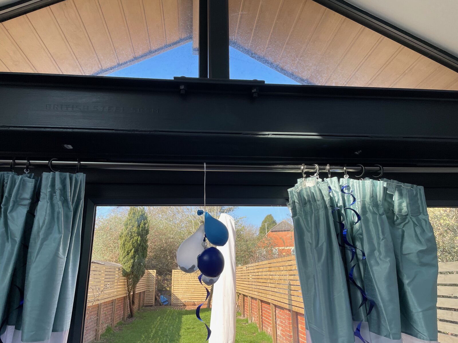

Hi There.
I hope someone out there can help! I've been charged with "making the curtain pole stay up!". As you can see from the uploaded pic, I got a guy to try to glue a couple of pass-through brackets (using sticks-like-sh*t) but sadly it wasn't as strong as our dog!
From what I've researched out there it suggests I could (get someone to) fix it straight into the RSJ using "self-tapping" screws but is this really a safe thing to do? Will this not affect the integrity of the RSJ? (Will the structural calculations made allow for such eventualities?)
Assuming it is - the curtain-bracket hole (for the screw) is ~4mm. Are you able to get screws this small in diameter which will suit, and which would be the best to get? (Also, looking at the space I suspect they need to be pretty short too).
Any advice greatly received.
Many, many thanks, Steve. (A bit of a novice).

There is no problem drilling into the rsj.
4mm self tappers are readily available.
Self tapper work well in sheet steel, but thicker steel needs to be drilled and tapped. An M4 tapped hole will not be a problem.

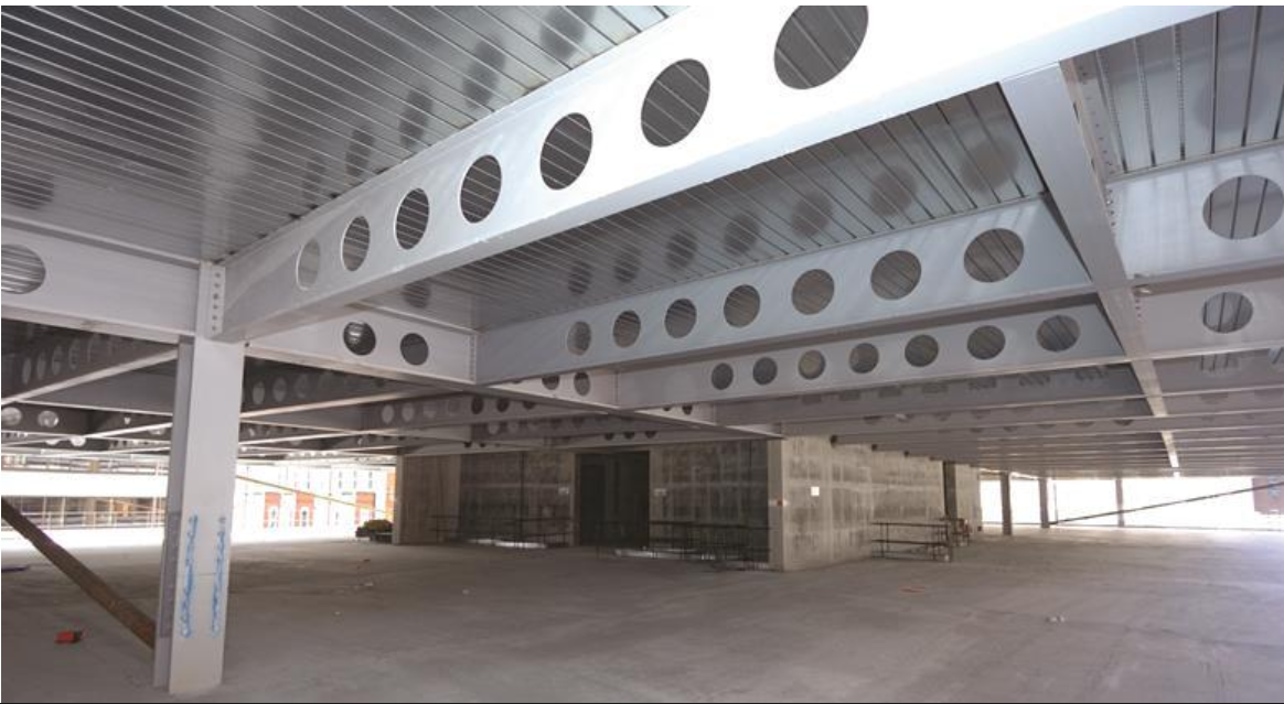

.....and you're having sleepless nights over a couple of 4mm holes in your beam................?

Thank you. Do you have any recommendations? My (handyman/tiler!) is here on (this) Monday and has asked me to get relevant bits (Tungsten HSS, I presume?) and screws in advance. (I guess it's likely to be an Amazon job).
Am I right in thinking I need to get bits which are 0.5mm smaller than the screw?
Thank you so much for the fast (and comforting) reply. As per my last - and apologies to lean on you more - do you have any recommendations for both bits and screws (see post above)?

(My last!) I've measured and the curtain-bracket holes are actually just under 5mm. (A 5mm metal drill bit will not pass through when turned). Is M4 the right choice? (Or is there something in-between?). Thanks!
