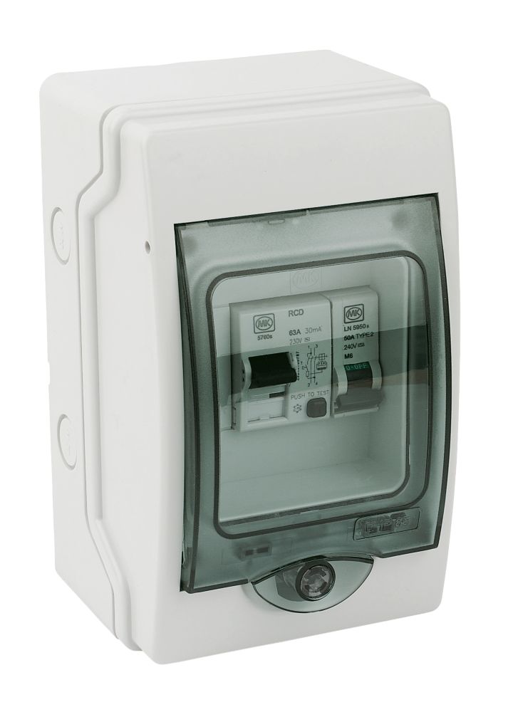

An electrician would need to add a little shower unit with a an RCD and MCB in it such as:
ae235
Dependant on the size/age of the cable he may also need to replace.
Your best bet is to get a spark in and quote you for the work
ae235
