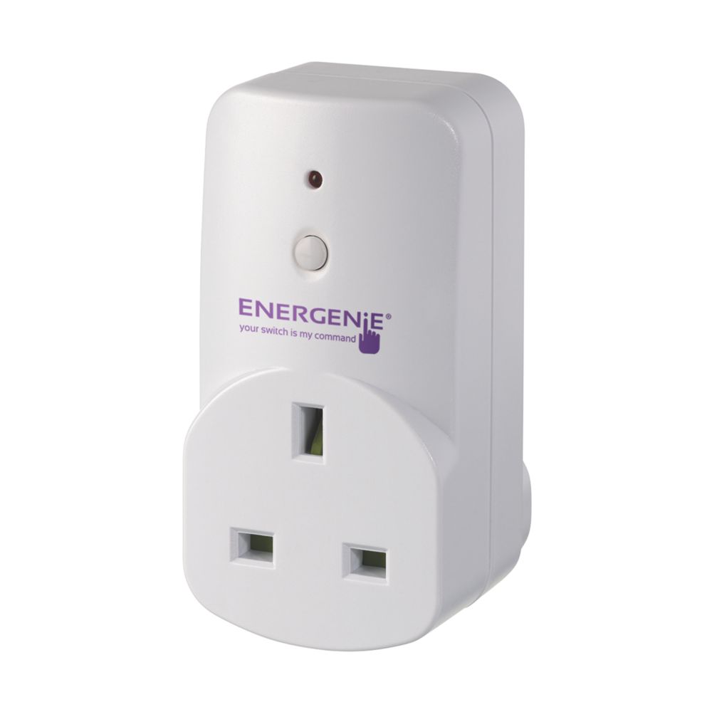

Using one of these
5642H_P

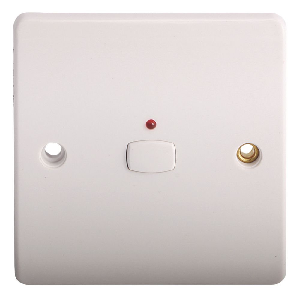

anyone would realise it is some sort of smart device and it may auto switch on. But using one of these

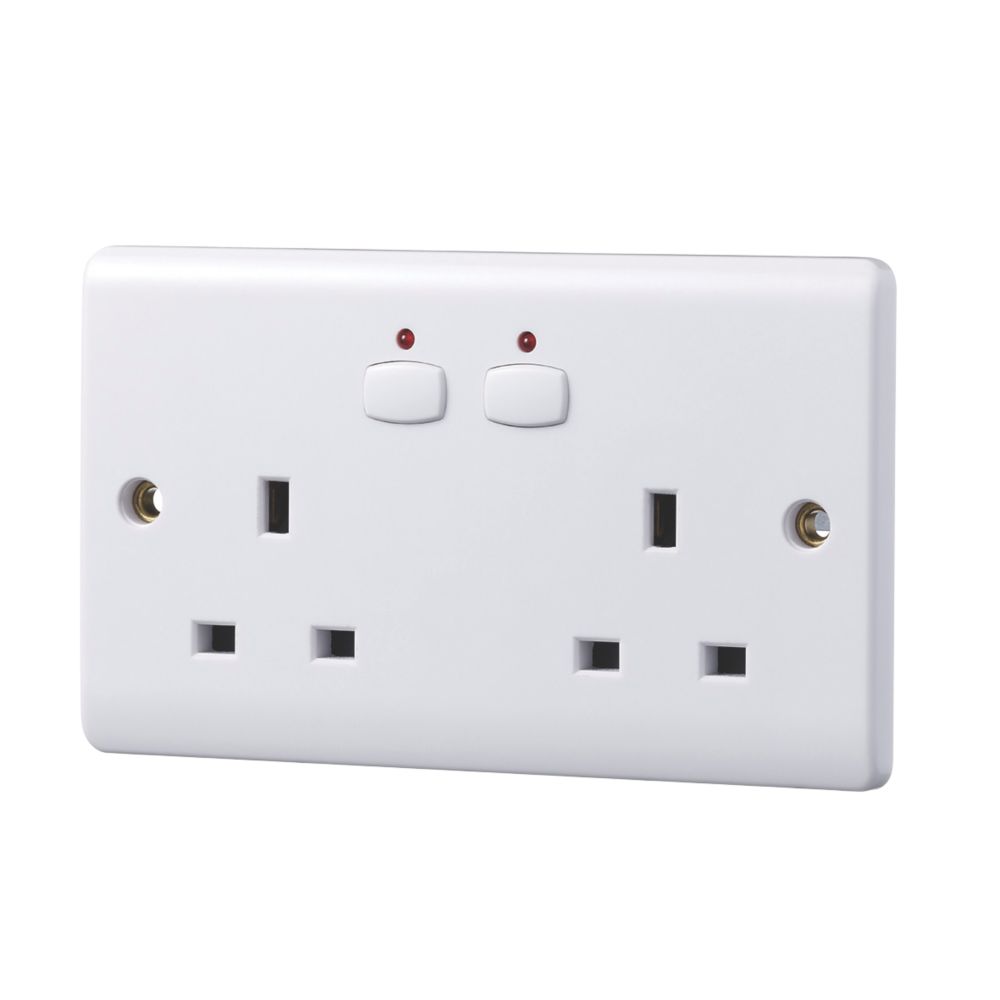

there is nothing which shows this may auto switch on. Same with this
7955H_P
there is nothing to say this may auto switch on, and of course with the socket would not want a freezer plugged into it, as with a power cut it would remain off.
