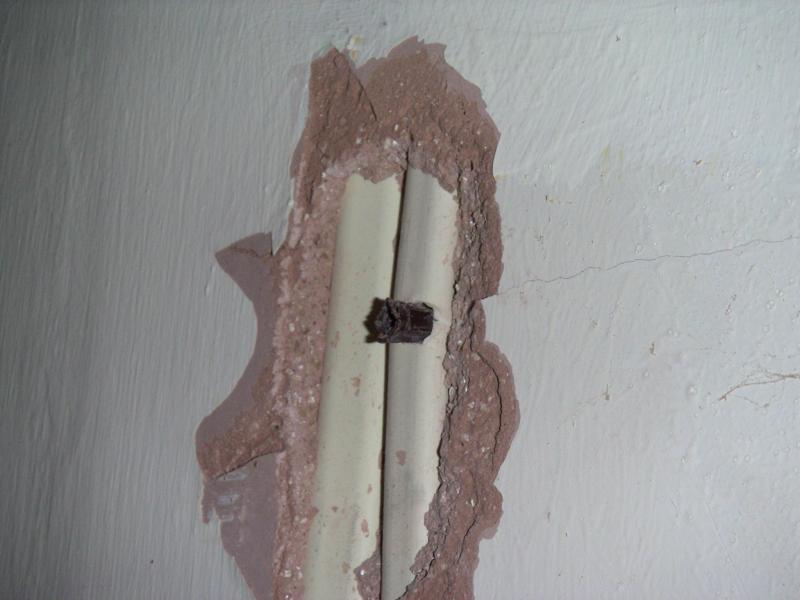

I will be getting an electric safety certificate for a property I’m going up to rent out. I haven’t changed any electrics and they are as they were when I bought the house. My questions are,
What regulations would the test be against? Current regs?
And what happens if some cable were run through unsafe zones?
The regulations that would be used is British Standard 7671, Requirements for Electrical Installations, 17th Edition, or the 17th ed for short and Part P of the building regulations.
What you will be having is a Periodic Inspection report, faults or areas of non compliance are notified and rated ie: 1 being bad needing immediate attention, 2 requiring attention etc...
The regs are not retrospective so if you have a cable running in a wall where it is no longer permitted this would be noted fairly low, if however you have a toggle switch in the bathroom or a cable not up to the job that will get a 1.
You don't "have" to do anything that is reccomended, but if you don't and someone is hurt as a result you will be in the...
I would get all the code 1 & 2 defects dealt with, thats what our local authority does when we PIR places for them

The accepted unsafe zones are anywhere that a cable can be expected. This means all cables should be run horizontally or vertically to the accessory they serve, so a socket will have its cable/s running straight up, down, elft or right. Ditto a light switch or a wall light, etc. Also unsafe are anywhere withing 150mm (six inches) of the corner of a room, and the same below ceiling level. In theory it should be safe to drill or nail anywhere else on the wall.
BUT ... it's never quite that simple in practice. Lots of people don't know the rules, and particualrly when you go back to the '70s and '80s and the heyday of d-i-y, cables were routed in all sorts of imaginative directions.
Generally speaking the dangerous room (domestic) is the kitchen. Most people, when they rearrange a living room or bedroom, move the furniture but then run extension leads for any appliances. When a kitchen is refurbished al lthe wiring and plumbing gets moved around then plastered over, so this is where Mr D-I-Y may well have left a trap for the unwary.
Sometimes the "unsafe" zones are confusingly referred to in the trade as the "safe" zones, because these are where it's safe to run cables. Civilians need to think of them as "unsafe" - unsafe to drill or nail.
