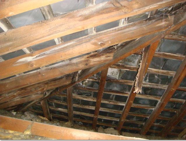

Hi,
is anyone able to suggest how to deal with a sagging roof please?
The hip rafters on both sides of the roof are sagging a bit and the tiles have started to lift up like birds feathers separating. There appears to be a little bit of water damage to the rafters on the inside.
Can anyone give me any suggestions as to what my options are for repairing this and if possible a rough idea of cost?
Thanks for helping.

Yes time for some roof work.... Slates look good so reusable, Timbers will need a sympathetic chippie and some purlins. etc
I think your neighbour may have had theirs done.. see who did theirs
Its not clear if the slates need replacing, but you certainly need to sort out the leaking
You will never get the sag out of it now though. Whether the sag is just due to continuous dampness to the timber or due to undersized timbers, or whether it needs additional support now needs investigation
The roof does not look that big, so at a guess, £5k for complete replacement of the slates

No, it is an unnecessary expense to replace the rafters and hip - that is a massive job. £5k would be just for the felt, lath and slates - a bit less if slates are re-usable
Many roofs sag for many reasons, but that does not mean a problem with the actual roof structure.
If the unevenness of the roof bothers you, then I would be inclined to fit new timbers to the sides of the existing afters which would form the new roof line ready for lathing and slating, rather than removing the existing timbers. These may not need to be a big as the rafters.
A new purlin and posts to support the rafters at mid-span may or may not be required, or may not even be feasible, and someone needs to look at this. If there are no roofers or general builders with some experience in the structural side of things, then perhaps it would be worth spending £200 or so and getting a structural engineers' or building surveyors opinion - but having said that, they will probably be over cautious in their opinion, so be sure to give them specific instructions on what you want - ie the minimum amount of work required
Not to tread on anyone's toes but here's my 10pee's worth:
1. the sagging will not go away, it will only get worse with time and a couple of heavy snow loads.
2. there is obvious wet rot damage, in photo 2 the remains of a crumbling "prop" can be seen dangling. All this damaged wood must be removed. There are loose slates and buckled hip tiles and possibly water penetration inside the property.
3. In warmer weather strip the roof of the slate and examine the roof framing. Check how the foot of the hip rater(s) is fixed to the wall plate. Whatever happens roof felt is needed
4. Check to see if the roof is spreading or if the chimney stack and it's flashing is somehow contributing to the problem.
5. post more pics from different elevations -side view etc. Is the ridge line, between stacks, level?
6. is this a detached property or a bungalow? what ,if anything, has happened to the hips at the other end of the roof?
