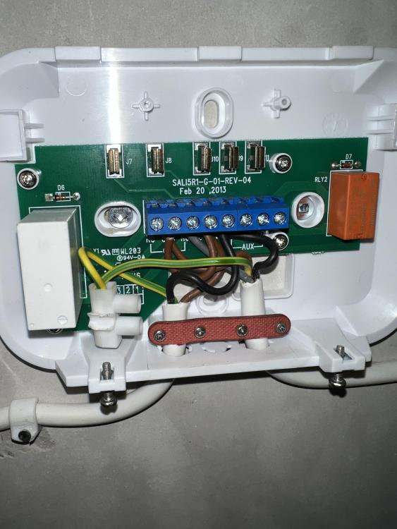

I recently purchased a Drayton Wiser multi-zone kit to replace an existing Salus IT500 system (This was installed in the property before we moved in).
I have attached the current wiring for the Salus system, the left white cable is from the isolator switch and the right white cable goes to the boiler.

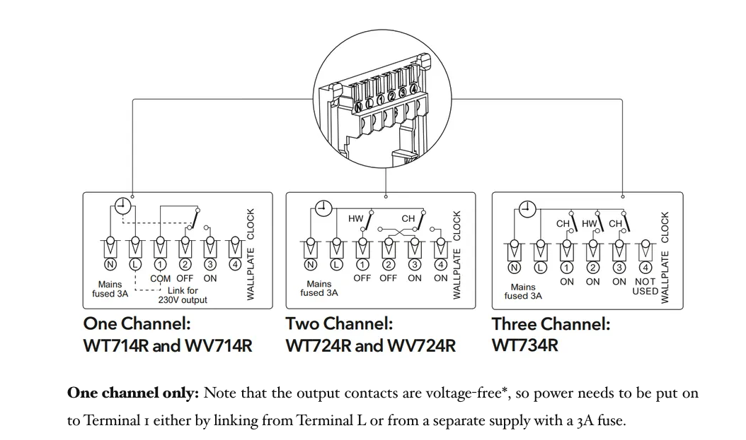

Can anybody assist with the wiring to the Drayton Wiser system?
I'm wiring to a single zone heating system with a combi boiler (Ideal vogue C40 max) - This is the One Channel part of the wiring diagram.

Pretty much identical to what you have
L to L
N to N
COM will need a link to L (as you already have one on the Salus your boiler must need mains switched)
NO to 3 on Wiser (grey wire)
Would make sense to put 2 browns in L and 2 in COM (as the Salus is currently) to avoid trying to fit 3 wires into L
Wiser backplate has a terminal at the bottom for your earths.
you said "I recently purchased a Drayton Wiser multi-zone kit" but indicate "I'm wiring to a single zone heating system with a combi boiler".
Can you confirm which kit you purchased as the wiring requirements for the 1-channel Wiser differ to the multi-channel versions. The details above from mcprinter apply to the single channel Wiser only. Or when you said multi-zone was that meant to be a single channel Wiser in conjunction with smart TRV's.
Hello, yes, sorry, just to clarify.
The product is called a Wiser multi-zone kit 1. It only has a single channel (I think this is what determines the wiring?).
The multizone bit is due to the TRVs that can be used in conjunction with it :).
Better to be safe than sorry. Seems like you are good to go.
