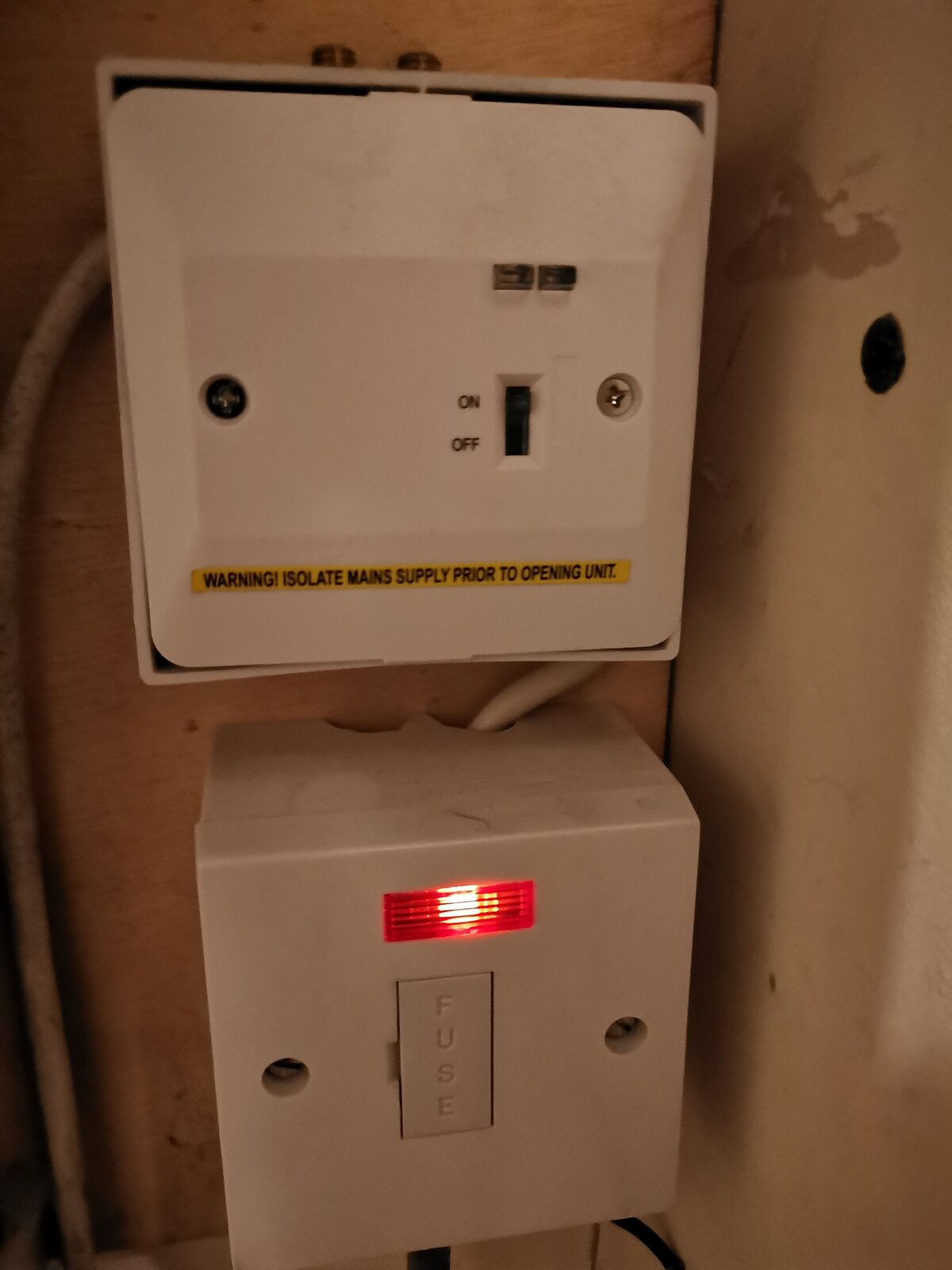

Able to post photo of receiver? When you say it goes to start to fire up, what sequence does it get to?
To be honest I've just been up and it only attempts to start after it's reset. If I turn the stat up and down it doesn't try to start. I'll get a pic but it's just a facia with a on/off slider and 2 oblong clear squares (which I assume should be the lights)

This is our receiver... Not the same... Inside is just a wiring connection..
*update*
Having just looked at salus website, mine appears to be the origional receiver they made
