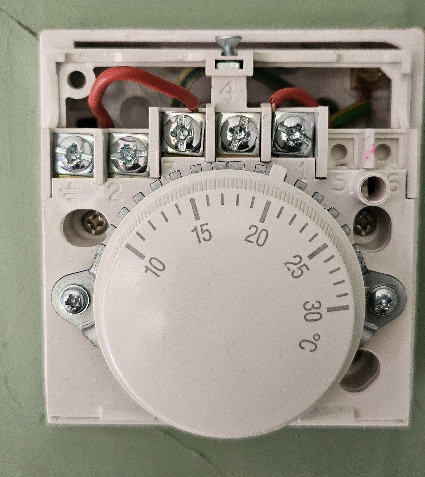

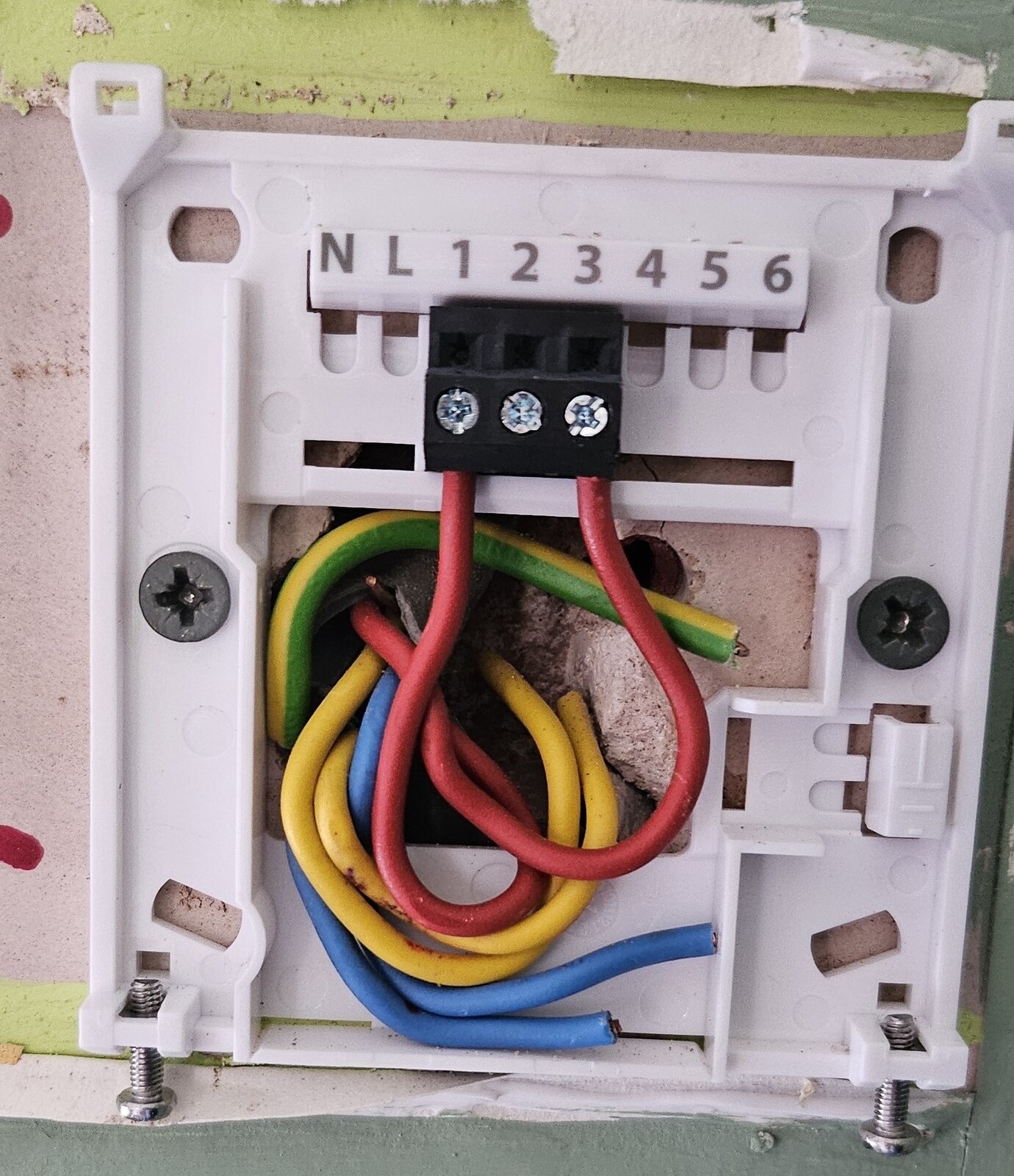

Looking to replace SALUS RT510 Controller + Honeywell Room Stat with Hive. Combi Boiler/Single Channel.
Can someone clever confirm wiring? Can't see a permanent L+N? Possibly the SALUS RT510 is a battery powered unit?

Yeah, I can't see permanent L or permanent N either. Likely live and switched live and battery operated as you say and the Honeywell just live and switched too. What combi boiler?
The rt 510 is a battery powered programmable room stat
Live in should be on 1 (common) switched live out on 3.
Why you also have a separate thermostat really needs checking out!.
Turns out the previous owners must have had the Honeywell left in so as not to make a mess? But was working (trying to) in conjuction with the Salus.!!
Why on earth it wasn't linked out who knows. It is now though and the Hive is up and running
