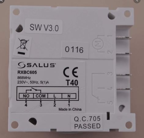

Hi
Bought a property with a Salus 501 transmit and the 605 receiver. It has kept losing pairing for a while, so I took one of the jumpers off the transmitter and now the receivers relay cliks every second with a solid red light and I can't pair anymore..

Is there not a little switch marked Auto / Manual on the front of the receiver? If so switching it to manual should achieve what you want.
If you simply unplug the wires, I believe that the switching wires (Com 3, and NO 4) would be permanently 'open circuit' and so the heating won't work.

The unit does exactly the same thing regardless of auto/manual unfort..
Could I leave wires 3 and 4 connected, and disconnect the 1 and 2 which I know have electricity (given that I accidentally touched both at the same ;)))) having forgotten the mains was on - WON'T DO THAT AGAIN)

you will have to see which numbers are NO and Com and join these two wires
Thanks Ian, at least I can get heating then in the evening. If I can't connect them, tape the metal ends together? (sorry for my naivety)

Nope shouldnt make any difference, but removing a jumper on the thermostat alters the frequency so you would have to do a manual rebind and yes salus are shoite, most likely your problem was cheap batteries you have to use decent alkaline batteries like Duracell

According to that you join 3&4 but check first, dont understand when you slide it to manual that it doesnt bring the boiler on as in effect you are doing the same thing
To be fair, it probaly will do, but I didn't give it a fair test as the boiler is in the same room where the nipper sleeps and the clicking was disturbing him, I will try tonight. I was all set to do a rebind but I am stuck with the solid red light and the clicking...My boys aren't with me tongiht so I will leave it clicking to see if it turns on eventually after the demand for heat phase kicks in
If the switch doesn't work, ideally the wires going to 3 & 4 should be cut and joined together. However as a temporary fix or as a test, sometimes I've removed the connector, inserted a wire link between terminals 3 & 4 then replaced the connector to trap the ends in place.
