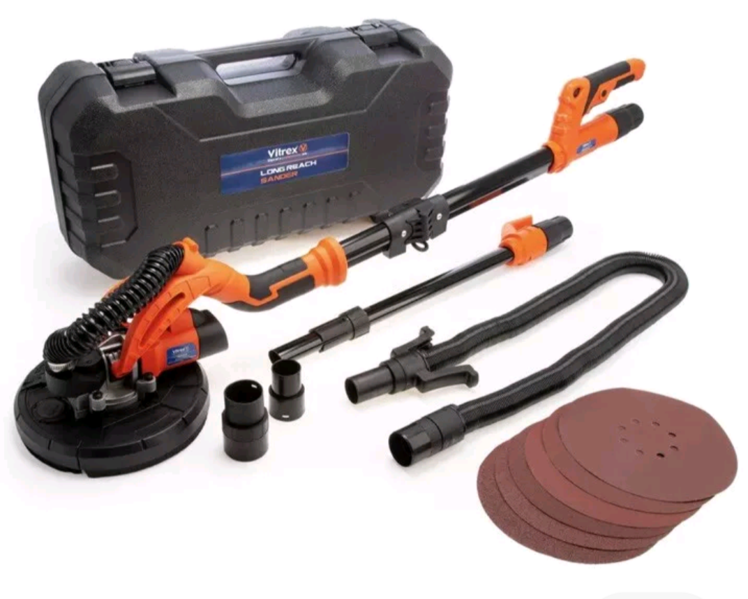

I'm doing my own skimming. Finish, especially on the ceilings is "average" so will need some filling and sanding, probably easifill.

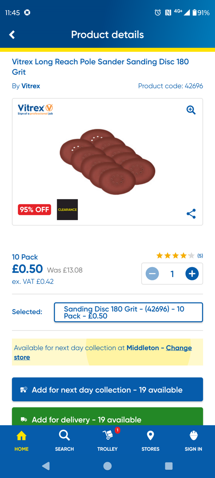

I have a vitrex pole sander and am wondering what grit for the discs? Although what I really want to know is would these do the job? I suspect a bit fine, but hoping I'll be sanding more of the soft easifill than the plaster. I have a very large area and they're practically free!
Also, would you mist coat first to show up the bad areas or sort the obvious bits first and then mist coat to pick up the finer stuff?
Thanks.
120 grade I used most of the time.
Just start and stop sander on surface.

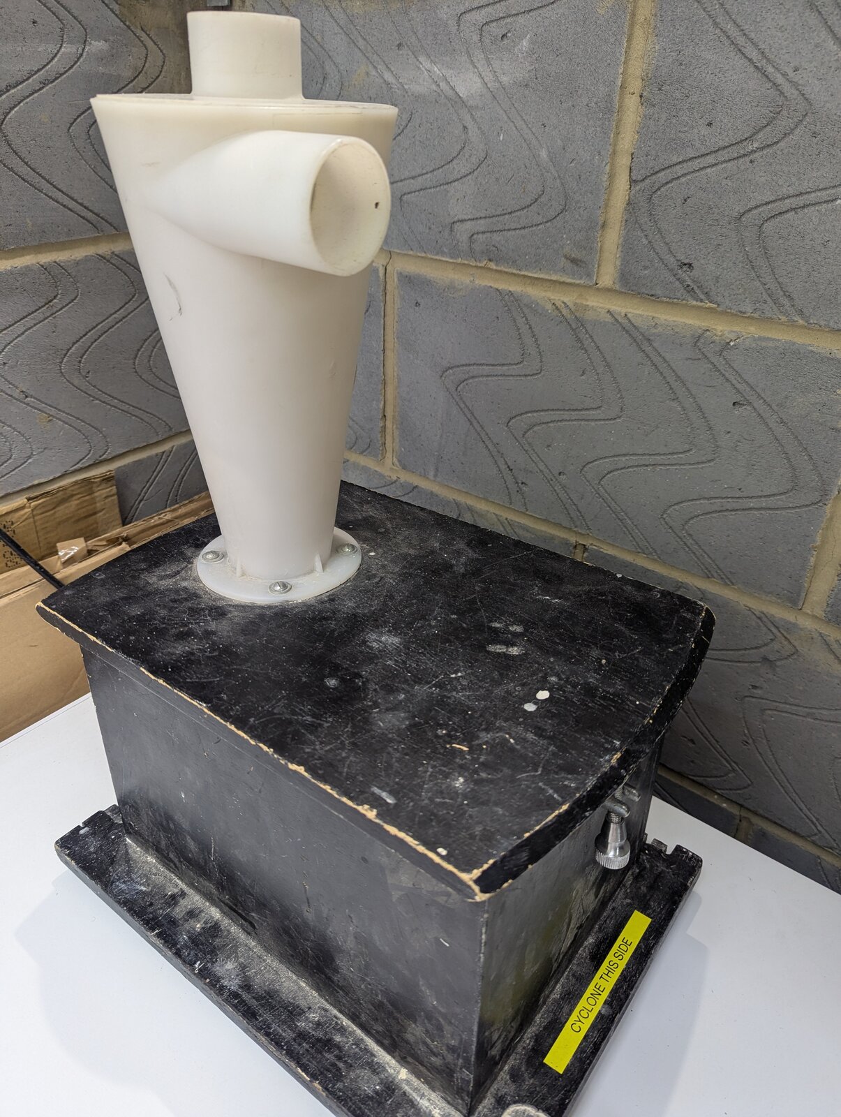

I built a cyclone cheap to catch most of dust to save vacuum.
180 grade don't do much to surface. Good enough for a lighter sanding.
You can use 80 grade for rough spots or high spots. Really takes it off though..
Don't mist coat first. Sand bare plaster
That sounds interesting. Seen your picture on the plasterers forum. Found the cyclone on eBay, is the box just a collector? You mentioned using an old Dyson (which I have) - does that mean you'd strip the cyclone out to be driven by another Hoover (eg my Henry) or use as is?
I would go for 80 grit to flatten the ridges in the plaster and then 180 for the Easifill.

During the lockdown(s), I purchased a cyclonic cylinder (DIY jobbie) . I found that it would only divert heavy particles into the other bag. All the fine dust, which i was trying to deal with, went straight in to my dust extractor bag. Admittedly, my cyclone was only about about 10 inches tall.
Can you provide links/hints/tips?
My understanding is that cyclones let fine dust spin through and only divert heavier items.
I was tempted to divert from the cyclone to a water trap, and then the pubs opened again, and I lost interest...
I made my own from a bread box I bought from car boot sale £2.
Reinforced the bottom with ply.
Draft excluder and 2 sash window clamps hold lid on.
Made some pipe connectors.
Catches fine powder dust. Will also catch paper and bigger stuff..
If you prefer a barrel for water then
It's a must for dust filtering. Vacuum bags clog up too quickly otherwise especially plaster
