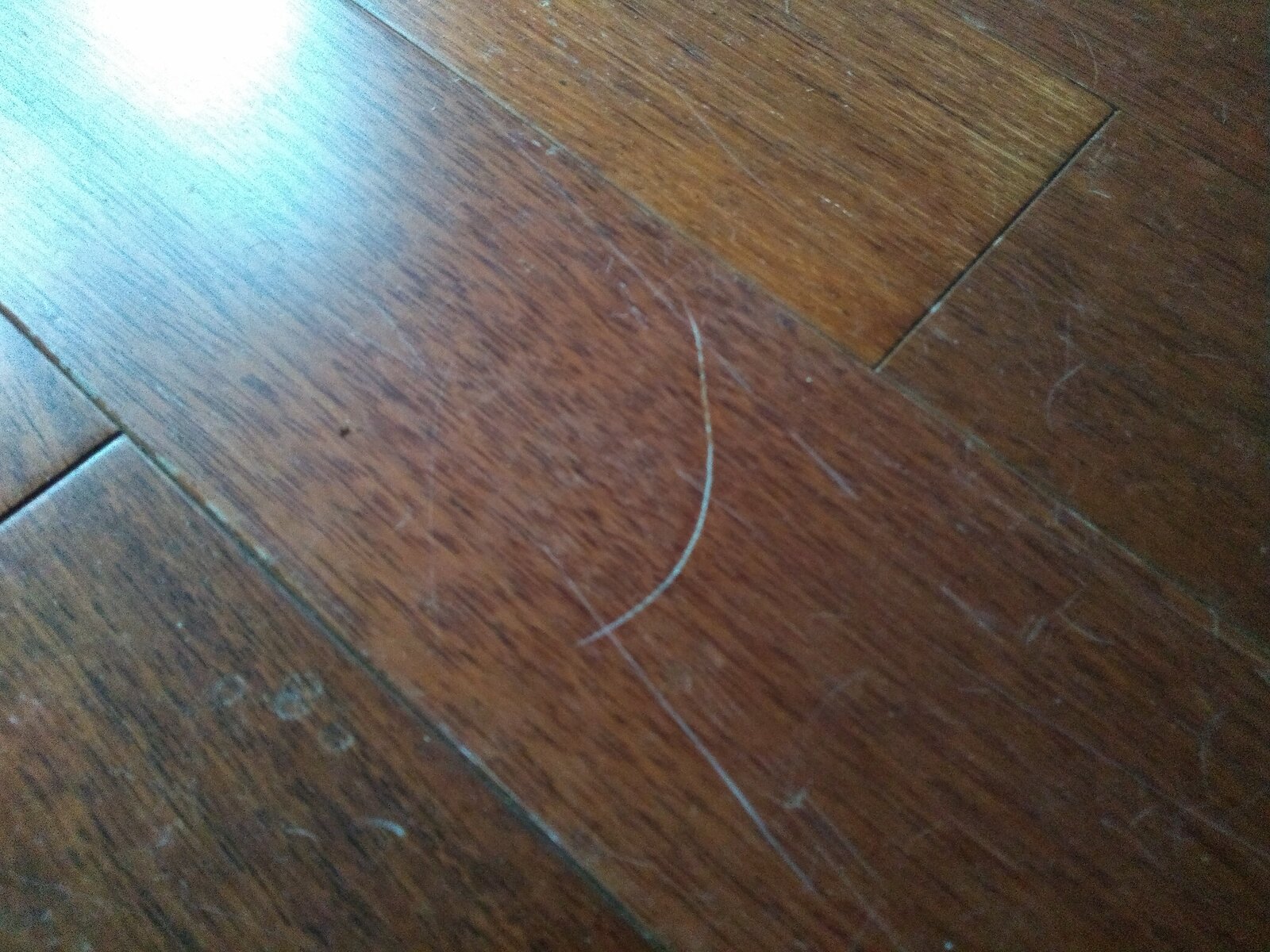

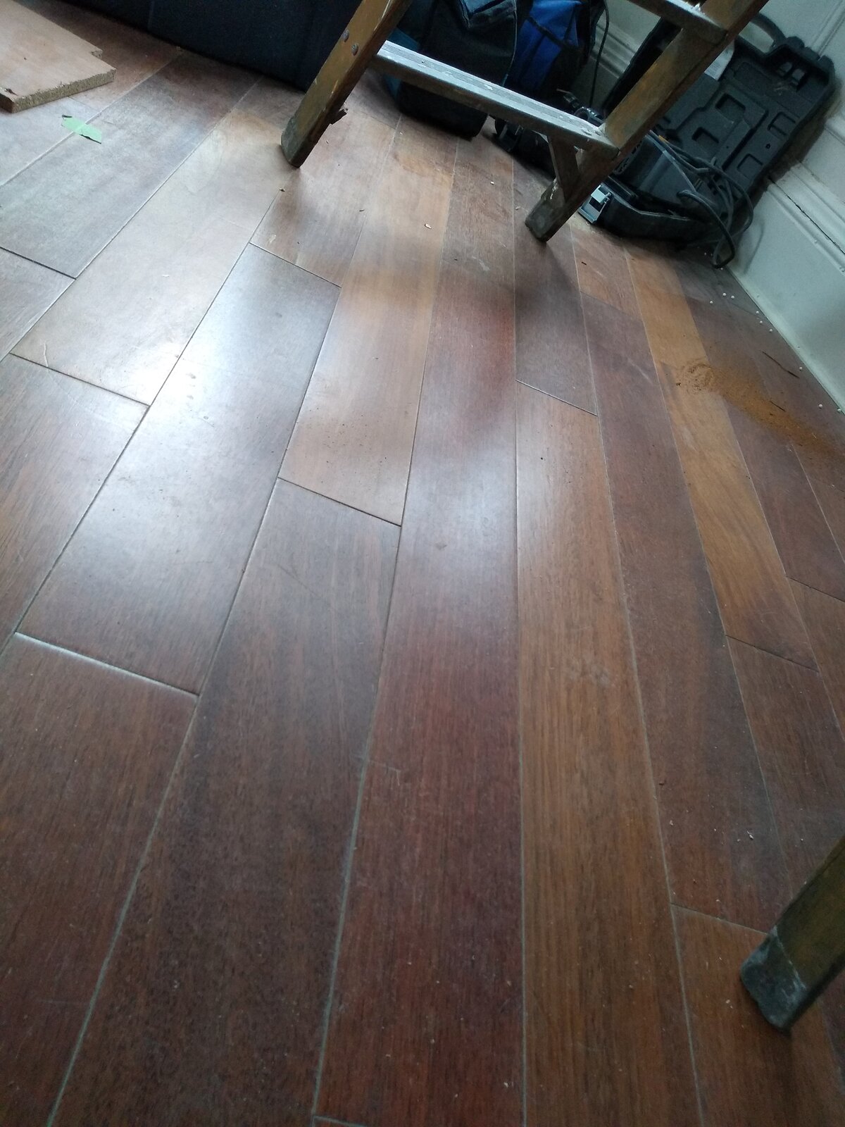

Going to make start on the floor next week, and I was thinking of going with an oil finish instead of the current varnish. Just wondering if there are any issues in changing from varnish to oil. I'm presuming it will be fine as the varnish sits on the top, so if its sanded off I can't see what problem would be, but always worth asking.
However, I have no idea what kind of wood this is as it was down when we moved in and I should probably take that into account when choosing a finish, so if anyone could enlighten me that would be great.
I am wondering if it is Bamboo? It is solid wood (or grass if its bamboo)!
