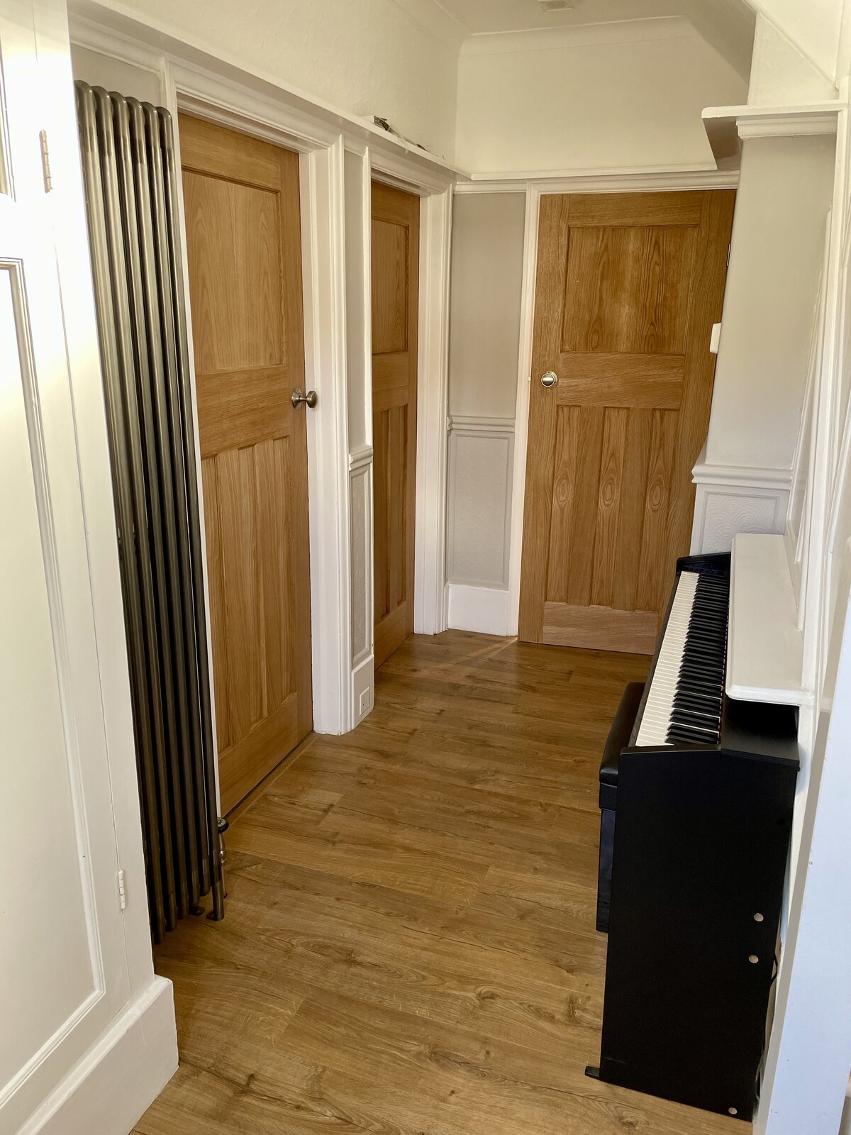

It is ok to sand oak doors with normal sandpaper? I've heard steel wool shouldn't be used as they could go black.
I've just had some internal unfinished oak doors fitted and I have some Osmo oil to treat them. They feel lovely and smooth but there are the fitters pencil marks etc that I need to remove. What's the correct method with oak please??

They had a similar issue recently and phoned Osmo who said their PolyX oil is fine for veneered doors as its low in solvent and high in solids, (which is what makes it expensive) and won't affect the veneer glue if applied in thin coats, so I went ahead and applied the oil. I first gave a light sanding with 180 paper in the areas that had fingermarks etc, then applied the Osmo to the door mouldings with a small dishwashing sponge, then used the Wooster rollers for the remainder of the doors.
I didn't wipe with meths, as the door supplier told me not to. But it's frustrating getting contradictory info from door supplier and Osmo. Sometimes you just have to jump in and make a decision, and hope for the best.
Doors after 1st coat, second coat to be applied over the weekend....
