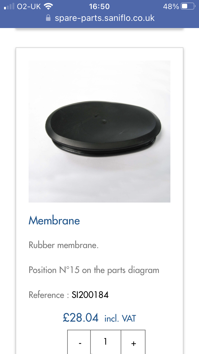

It's a 3 year old Sanislim, with 99% light (no1) use. It still works ok but it making the running on/over running noise.
To me, the noise sounds more rotational possibly without pump noise, so my best guess is it might be the blades spinning after the water has been pumped away. Does this sound feasible?
I replaced an existing older saniflo unit when I did up my en suite shower room so it was me that installed it. I can of course then uninstall it all (it drains the shower/sink too) but if I go for ripping it all apart I'd like to be sure I know what's wrong and how I can be 100% sure it'll be fixed ok. Maybe by pre ordering parts. I think it's either this or buy a new one but I see I'm looking at about £430.
Any help welcome thanks.
Sounds like the flow switch is stuck on, it’s usually the rubber diaphragm that gets stiff with accumulated “stuff” and you can clean or replace.
Switch power off and leave soaking in descaler for 24hrs. May need to repeat a few times or have it cleaned internally.

The sound changes once the water has been pumped out and the motor/ pump combo keeps running and the blade is fixed to the motor shaft therefore must rotate as one.
Because you have just told us it dosent happen every time then it may not be scale, I have found chewing gum and other things under a membrane stopping the switch from releasing.

But the micro switch and membrane I assume are the only parts that could cause this? Should I get a new micro switch and membrane if end up dis-assembling..?

Most unlikely to be a faulty switch and not certain if the membrane is the oval shape on yours.
Thx. Looks like it’s oval. £28!
